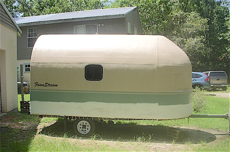

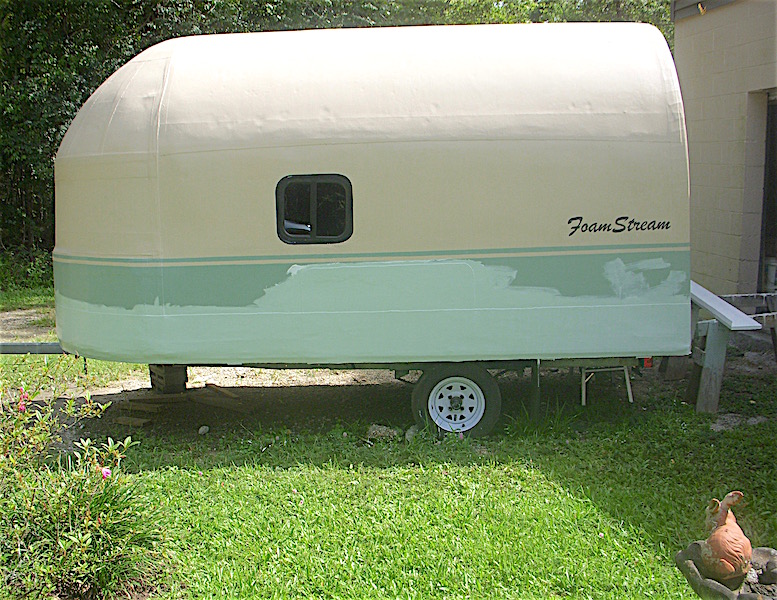

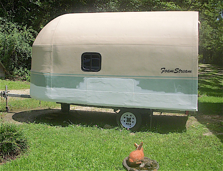

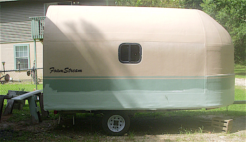

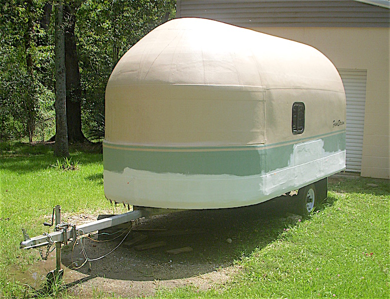

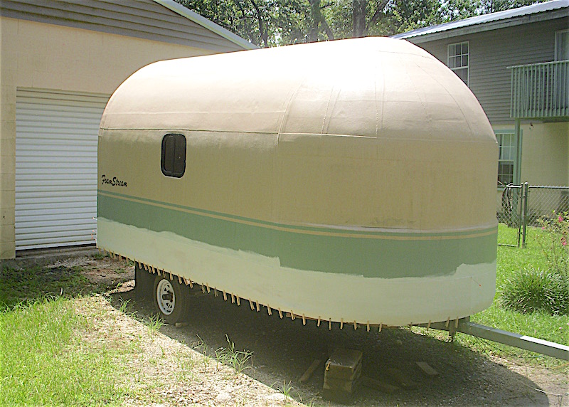

Postby GPW » Sun Aug 12, 2018 11:54 am
My helper came over this morning and we attached the rest of the canvas… the Strips … Plus one more coat of Gripper on the outside … ( after this one dries ) one more to go and then we paint ... :D The pics …
Re: FoamStream , the restoration … a lesson learned .
Postby GPW » Sun Aug 12, 2018 11:57 am
more pics …
note: clothespins held the canvas to the corner moulding while the Gripper dried … :thumbsup:
Postby GPW » Sun Aug 12, 2018 12:38 pm
I did just go out and paint the other #2 coat of Gripper on the shadow side ( it’s HOT ) . This time I mixed a little of the paint color in with it to help make the color transition , and show where I may have missed a spot … All looks good now …. This Foamie repair is even easier than I thought it would be … Hardest thing is waiting for a sunny day … ( and those baby birds :R ) ... :lol:

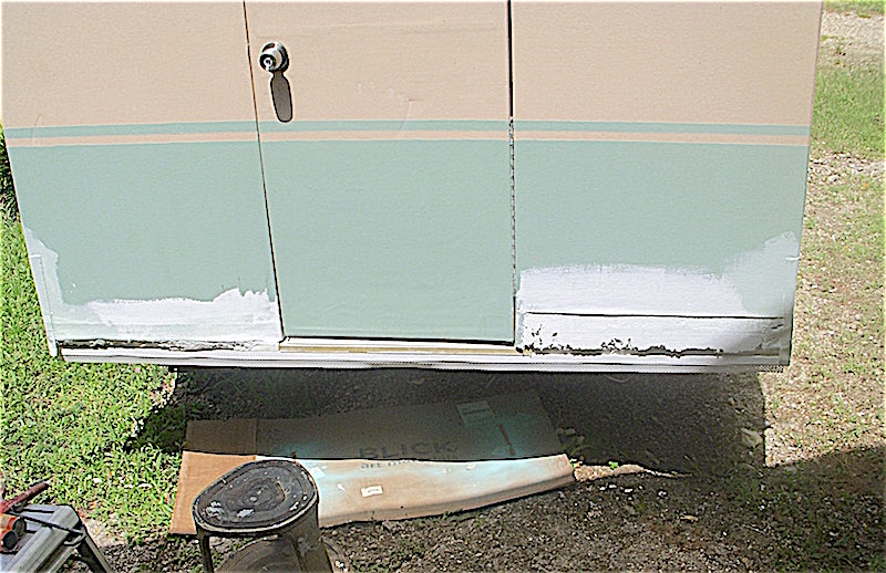

Postby GPW » Mon Aug 13, 2018 6:13 am
Just went out this morning to check how the morning dew and the drip edges worked …There were a few drops running down the side of the trailer and ending at the very bottom of the drip edge and then to the ground… The floor underneath was completely dry … :thumbsup:
Note: I highly suspect it was the dew all along that contributed to the softening of the previous floor … Every day that water would run under the trailer floor and keep the canvas WET … which in turn rotted the canvas and attracted Ants … grrr! :duh:
So the Big lesson learned , use Drip Edges !!!

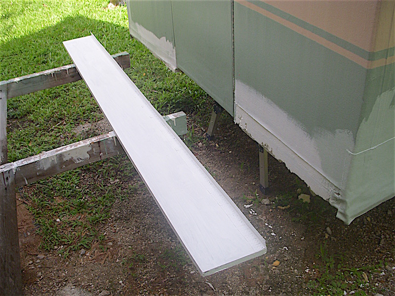

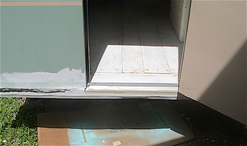

Postby GPW » Mon Aug 13, 2018 10:24 am
Pics of the rear end floor board and green “tell-tale” primer …
Postby GPW » Mon Aug 13, 2018 11:44 am
Got the back board installed and floorboard … Threshold back in place … and now a little caulking here and there …. some canvas strips ,and we paint the whole thing … :D getting close now … :thumbsup:
