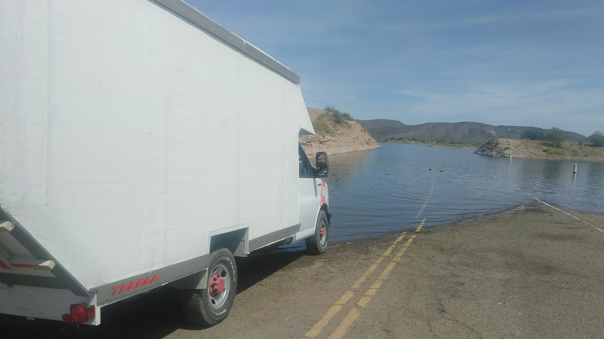

Postby Projector » Mon Apr 01, 2019 3:06 pm
So the adventure rig is out and about, serving utility for it's intended purpose. A weekend at the lake, but the road is washed out.
Do I dare go past the hazard bouys?
Do I or don't I? Should I or shouldn't I? :o
An oversized beer cooler should float right?
Next experimental trials, water bouyancy testing...
Make it so.
Projector

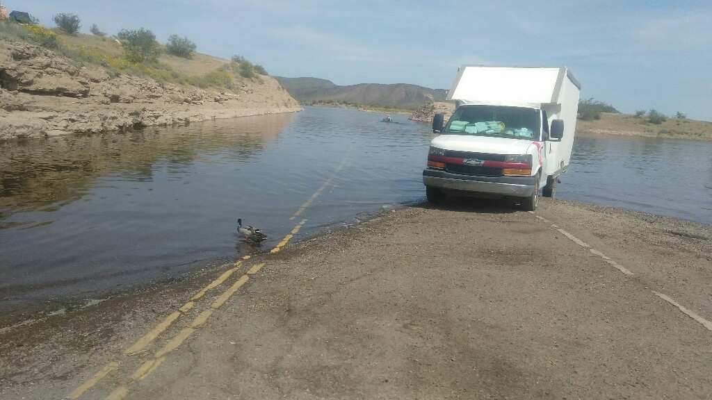

Postby Projector » Sun Apr 07, 2019 6:16 pm
Thx for the link but video won't load for me. Would have loved to see it.
So I talked to some experts before I commenced upon my water bouyancy trials.
They summed it up in two words.
Quack, quack!
I took their advice. ;)
Make it so.

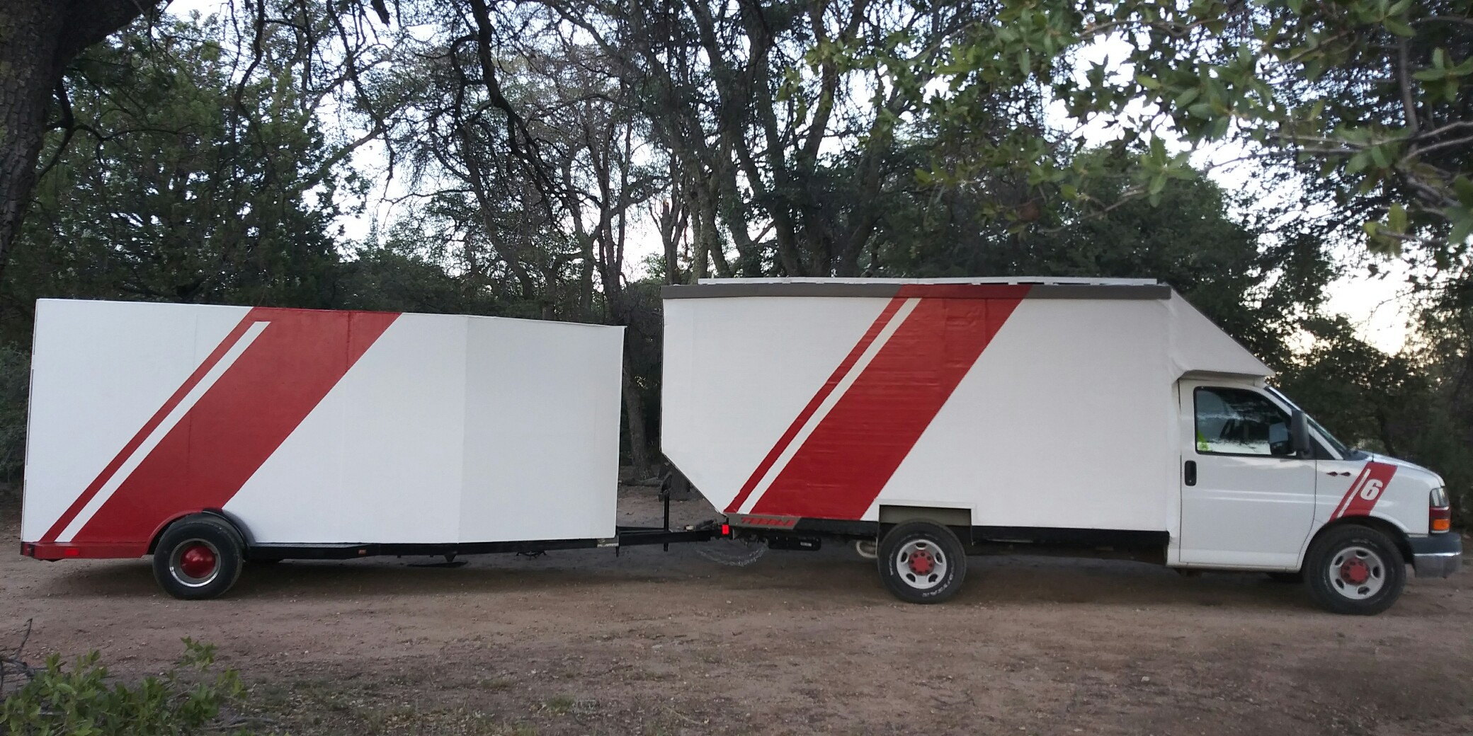

Postby Projector » Fri Jun 21, 2019 3:37 pm
A 6 month update after 5k miles on the road with 95+% hwy at 50-70 mph, temperature exposure from 110+F down into the 30s, winds in the 20-30 + gusts, constant Southwest desert sun exposure, rare occasional rain, highway buffeting and parked camping out :)
All the things to report, well, not much, so far so good. :applause:
My fabric to foam bonding has remained tight overall with no peeling, bubbling or delaminating. :thumbsup:
Yay, my prayers were answered, or effective application? :worship:
Only one small 2" stress crack at a seam which I cut out, reglued and sealed. That's it. Frame and structure have been solid so far. Pushing on the outer wall results in the entire box and rig moving as a complete unit.
Sufficiently framed for integral strength?
Only time will tell how well the overall framing and foam to wood bonding will hold up to on road stresses. Do plan on minimizing the external force impacts as much as possible through route selection and speed moderation.
Am finding the white box truck look a little too drab, needs some pizzazz.
Along with this crazy idea I have of :shock: needing matching wheeled luggage.
Make it so.
Projector
Posts: 159
Joined: Wed Aug 29, 2018 2:13 am
Re: TERRA6, Van cab and chassis 7*14, 4" Polystyrene
Postby Projector » Fri Jun 21, 2019 3:43 pm
Just a little pizzazz plus matching wheeled luggage.
8)
Make it so.
Projector
Posts: 159
