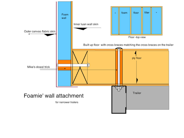

Eagle , here's a wall attachment drawing for a narrower trailer ... Image

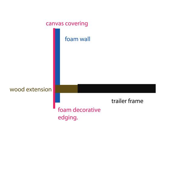

Postby eaglesdare » Tue May 10, 2011 9:37 am
i am back to putting the foam wall on top of the floor board. but i want a decorative edge on the bottom with the appearance it is on the side.
so this is what i just thought. the foam wall could go on top just like the first build. then for that decorative bottom just add another strip on the bottom of the floor, glued, once glued and covered in canvas you will never know its 2 seperate pieces.

Postby GPW » Tue May 10, 2011 10:11 am
Eagle , consider this ... Image

Postby eaglesdare » Tue May 10, 2011 10:30 am
oops sorry gpw, forgot to add the floor wood or whatever on top of that. should balance it out. that is how we build my first one., minus the decorative bottom edge.

Postby GPW » Tue May 10, 2011 10:33 am
OK, I get it now !!! That should work !!! (already Has huh? ) :thumbsup: 8)
