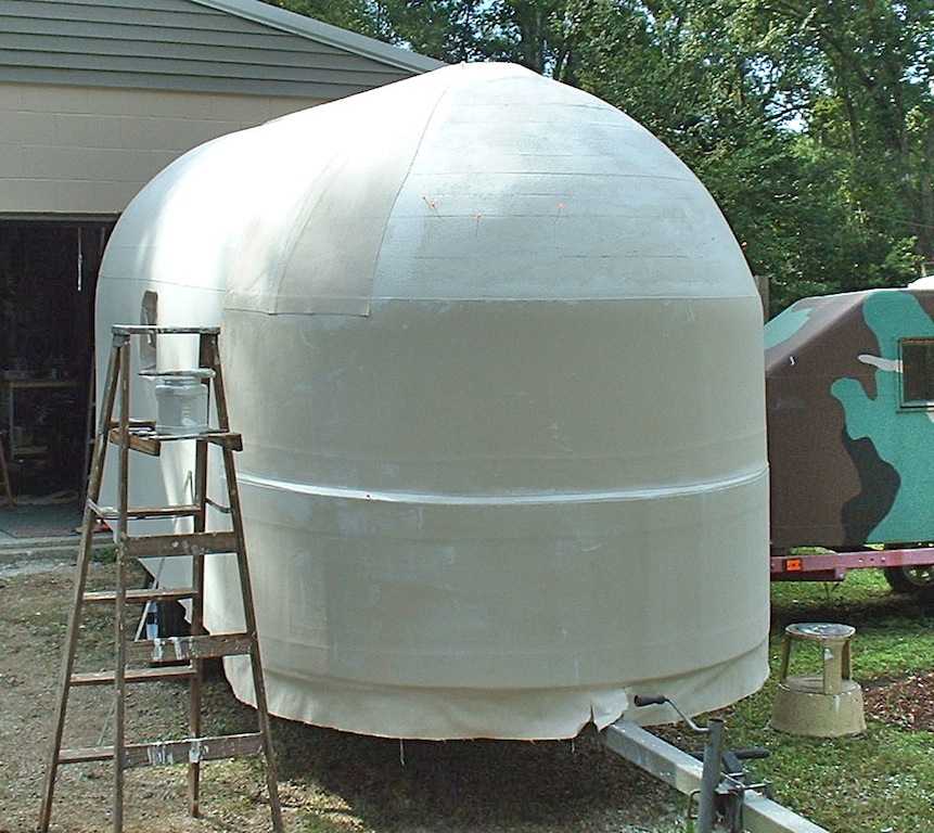

Honestly , I Chickened out and just used more Gripper on the nose ( :oops: ) , but this time completely wetting Both sides before application ... I think that will work ... Schmaybe' ??? The gripper is drying now , and we started adding the balloon gores ...

Finished the balloon gores , now just the keystone cover, and glue the front under the floor ... Getting close ... and it looks like rain ... :frightened:
I swear , if the Gripper sticks on the trailer as good as it sticks on my hands , everything will be OK ... :lol:

That's looking very good, GPW! How did you determine size/shape of gores? Any scientific, mathematical method or just guesstimate?

K’, The gores were determined by laying one up and seeing where the line fell out , once we had the one line , we flipped it over for the other side too ... BTW, that inverted gore in the front .... another “design element" ... :lol: :lol: :lol: Just the way things fell out :roll: ... I do have a million little threads to clip before we prime it ... small scissors and patience...

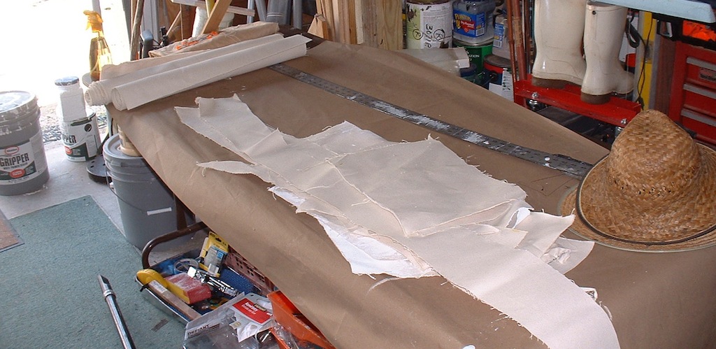

This is how much canvas we have left over from 30 yards .... Not enough to do a painting on ... This trailer really was a Canvas HOG ... :o The two rolls on the left , just enough for the keystone cover... just barely made it ... :thumbsup:

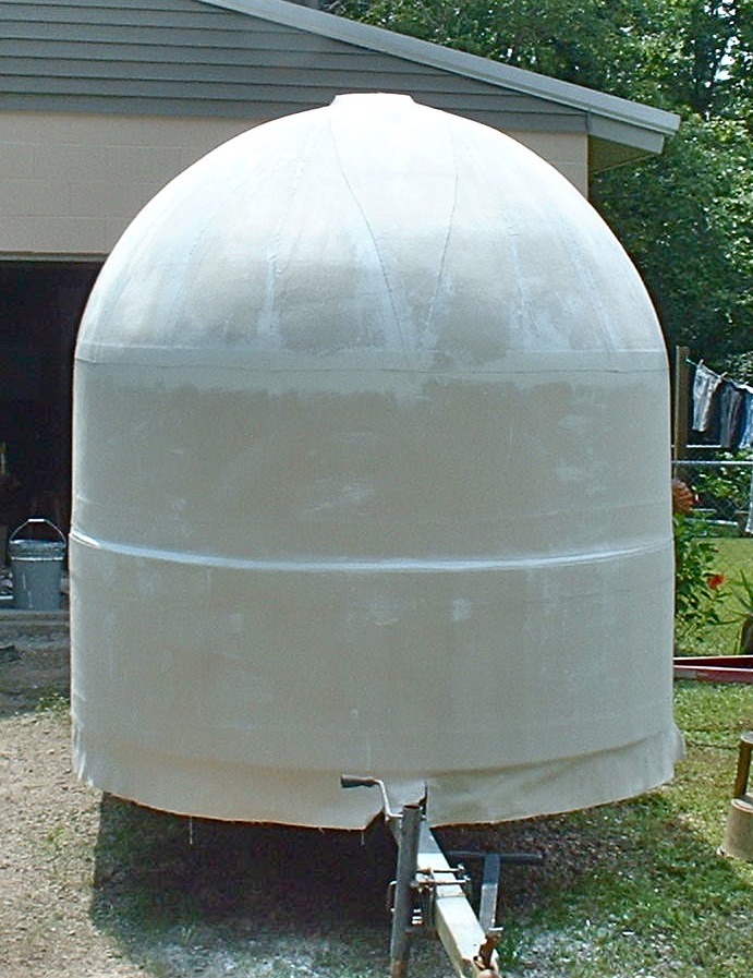

Checked the trailer , everything looks very dry now , no bubbles , no separations ... and best of all No rain .... yet ... Hope we get time to prime the nose and put the keystone cover on .. still a bit HOT out yet ... have to wait a little while ...but not too long ...

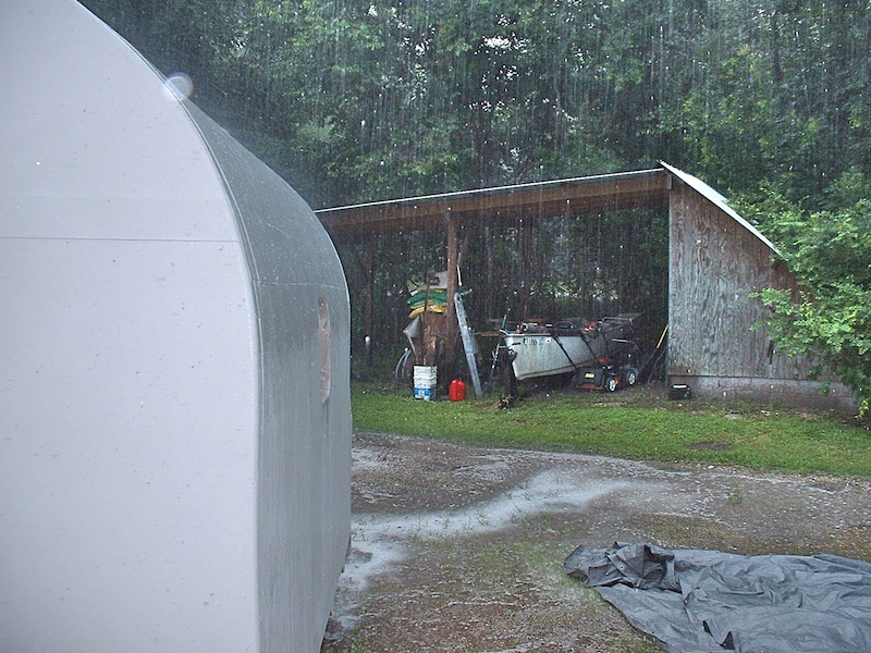

Another test .... we’ll see how fresh Gripper does in the rain ... :frightened: Came out of nowhere and here I am with a 12’ Aluminum roller extension in my hand :shock: ... Pouring rain like Crazy!!! :rainy: You can actually see the foam dust washing out to sea, or just further down the driveway ... :o

And as quick as it came up , it stopped ... leaving everything soaked ... the fresh gripper didn’t do too bad ... what’s left of it .. :roll:
Baby’s baptism of water ... Good thing it’s foam ... :o
And yes we found a couple small leaks ... you guessed it ... the keystone ... The only uncovered part on the cabin ... :R

It goes without saying that you will need to make doubly sure that that canvas is dry, dry, dry before you coat it with primer and/or top coat!
Maybe even run out there now before it dries and lay on a coat of mildly bleached water; help keep it from molding in your humid climate (good idea, bad idea????? please discuss).

It won’t mold by tomorrow morning ... I hope ... :worship: everything was Dry :roll: ... not anymore ... :frightened: ... covered it up and am quitting for the day ... tomorrow, we’ll see what it needs , aside from the covering over the keystone... ;)
