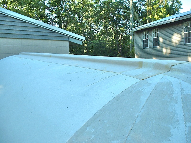

Working while it’s cool, :roll: got the keystone covered ...still going around pressing areas for a close fit ... another step done !!! Yes, more threads to remove ... :roll:
Did a test ... T2 does stick to the Gripper ... :thumbsup:

Oh oh. Looks like that cap should have gone on before the balloon gores. Now you need to find a way to keep that front seam from coming lose while driving. But I bet you have already been thinking about that.

Got the front Grippered’ ...just the keystone cover yet to prime ...
Apologies to KC ... it never really gets dry dry dry here... ever (have to move to AZ for that ) , so we just have to work with what we have , and a good deal of Dumb Luck ... Sun’s out !!! :D
Ps , there will be a “trim” strip added to the front where the balloon gores meet the front wall .. not necessary , but will look nice ... Still have to get to the Hdwe. and get the 6” fiberglass tape ,for the trim and “tension” bands ... The final touch on the covering , save the window fitting ... and vent which we are yet to find something suitable :thinking:

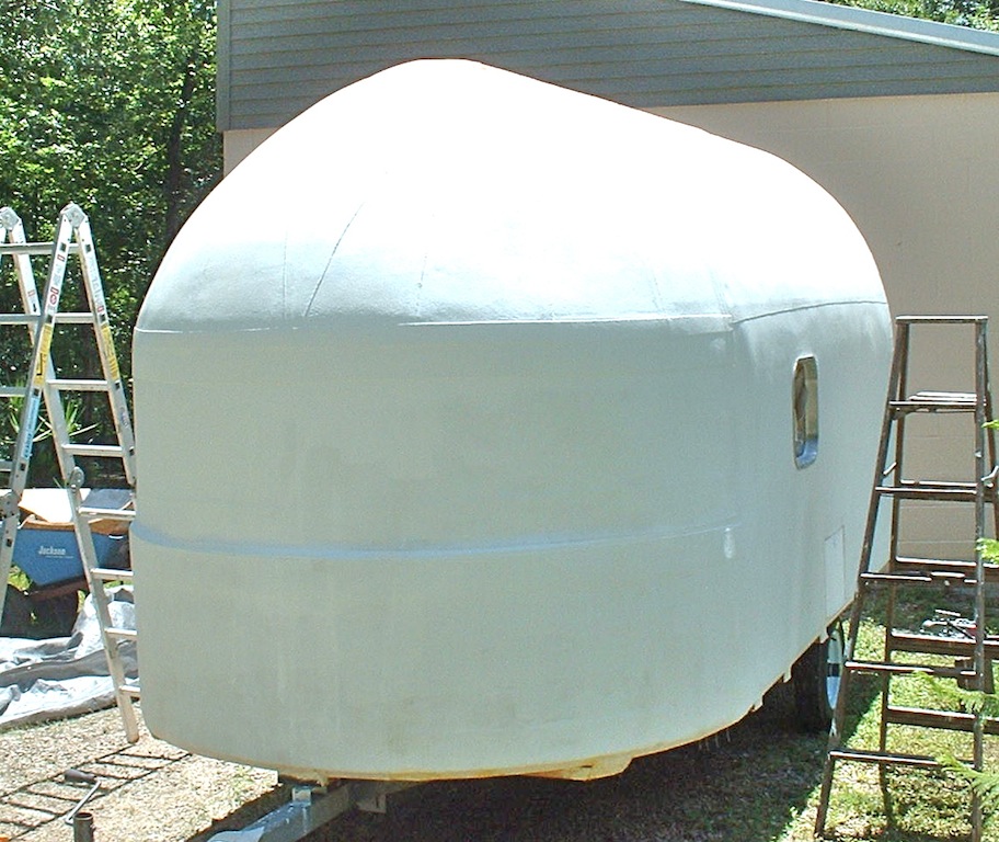

Got the front bottom tucked under the floor stapled and glued (T2) That’ just about wraps up the covering job ... finally ... 8)

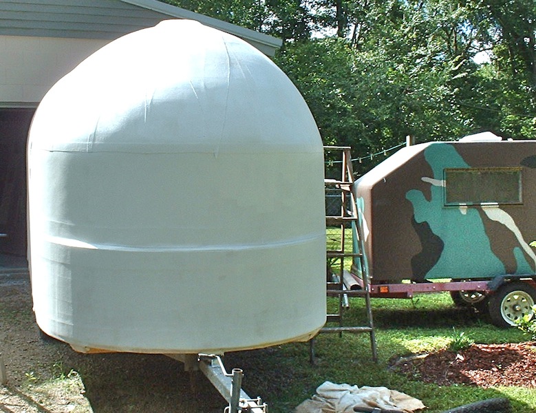

Ps. You can see how much Larger this one is than the little Foamie’#1 which the wife is now calling “GI Jane” due to the PINK trailer .. How much abuse can one take ... ??? :lol: :lol: :lol:

Randy , i doubt anything’s going to peel at the speeds i drive .. or evac speed (4.75 mph)

Added the trim strip across the front ... All this thick layered canvas , that’s just gotta’ be Strong eh !!! :thinking:
