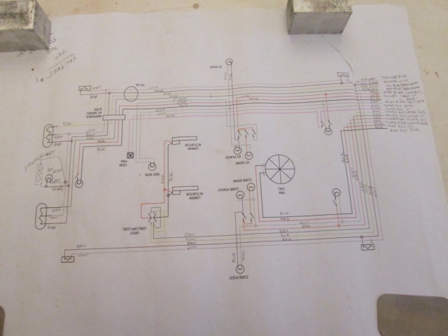

Also sat and studied the electrical diagram some more, making notes on what order I will need to pull the wires so that they train well and don't get crossed or bunched up at the critical junctions (it will be tricky enough as it is without making it harder as the passageways get crowded).
In doing that I realized that the case fan and red night light wires need to be pulled up thru the bulkhead first, so I will need to set the ledger for the lower rear cabinet first so that I can make the final hole thru the front face of the bulkhead for the red light location (I want to get this tucked up as high as I can under the cabinet floor, perhaps even cover it with a small channel shaped slat of wood that matches the rest of the under cabinet structure).

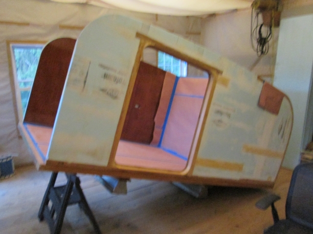

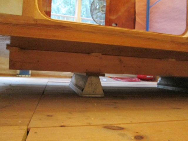

The dismount, folding up the metal saw horse legs and setting the work frame down so the cabin is at a better work height.

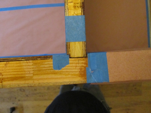

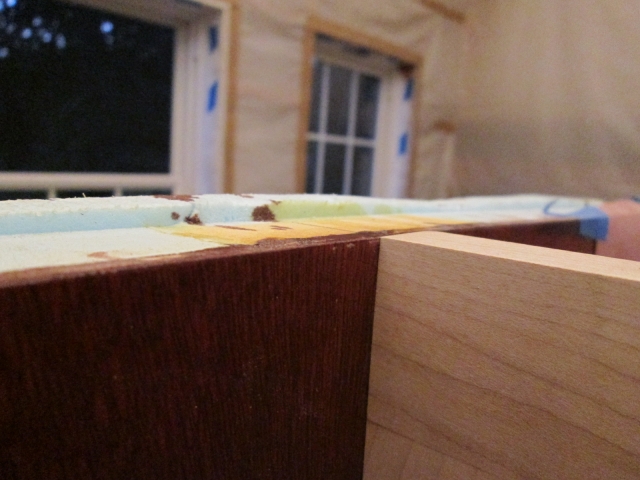

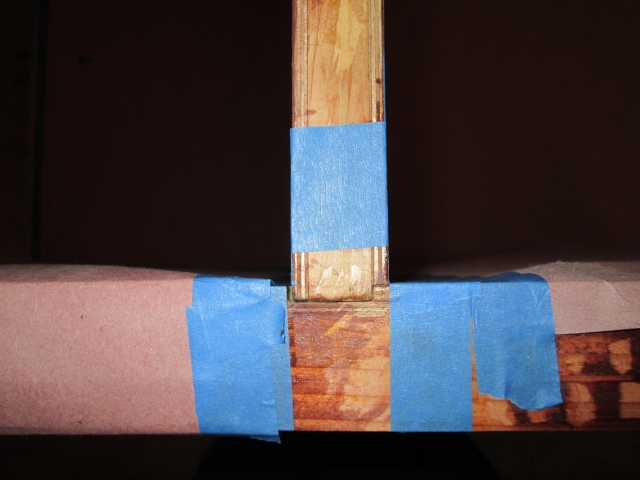

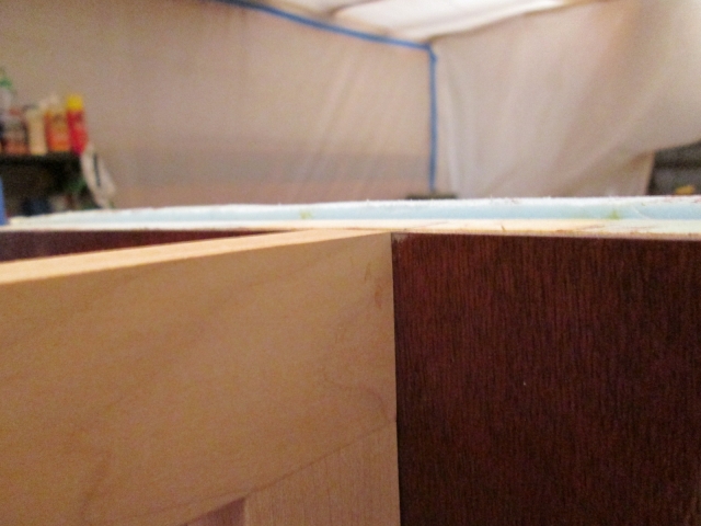

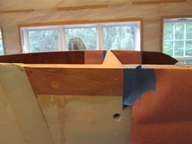

Looking down on the street side bulkhead joint (wall along the bottom, bulkhead in the middle). Note the blue tape pinched in the corner lap on the cabin side (left in pic).

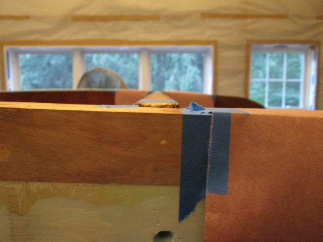

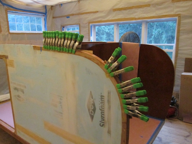

This is standing in the same location looking along the top of the bulkhead with the street side wall in the foreground. You can see how the front of the bulkhead is about 1/16 higher than the wall, and the rear is higher still due to the curve of the roof/ceiling. The front of the bulkhead ran down to flush on the curb side.

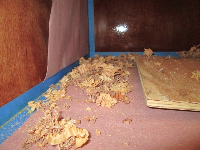

This is looking down on the curb side joint between the bulkhead and wall. Note that I managed to keep the tape out of the front of the joint (right side in pic) on this side.

Made some notes on the wiring diagram.

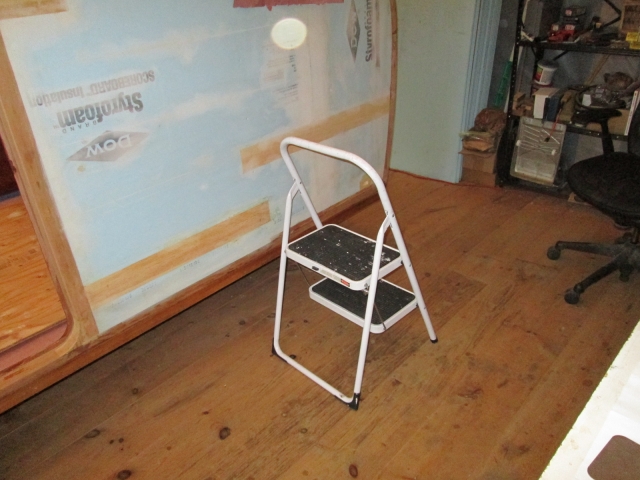

Brought a good step stool from home; a lot easier to maneuver and use than Karl's 6 ft ladder. All that I need for now.

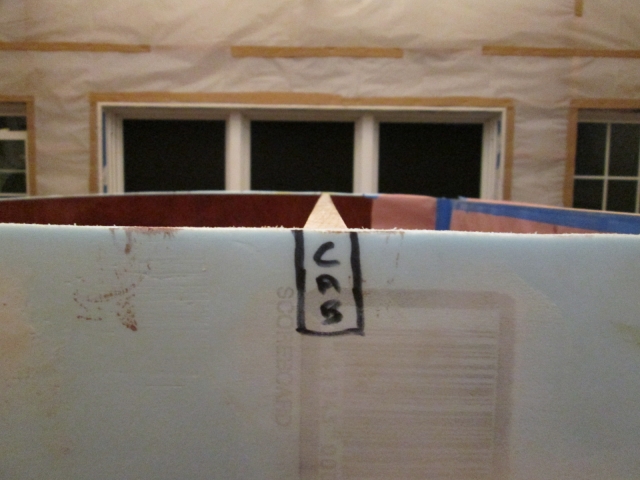

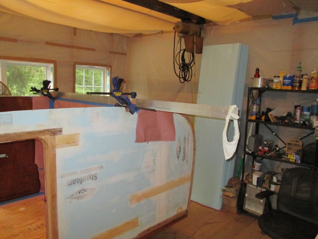

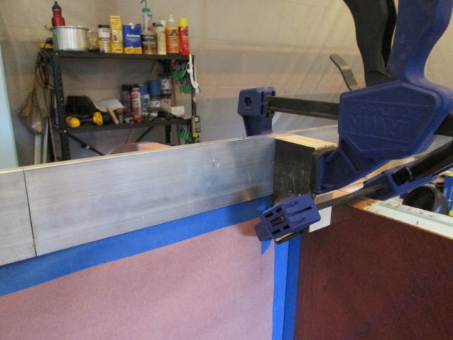

Used the alum. straight edge clamped across the tops of the wall in front of and behind the bulkhead. Cut thru the blue tape and poly with a razor knife then pulled the little whisper of tape off the top.
The white rag was to help me remember not to walk face first into the extra part of the straight edge sticking out. Worked most of the time.
Next I used the bigger Buck plane and worked the top of the bulkhead down to the lines, front and rear. It worked good and easy on the soft cedar until I hit a couple of staples! The blade was only nicked minimally (I caught it pretty quickly), and I shouldn't have much work to hone the blade back.
Here is the result.

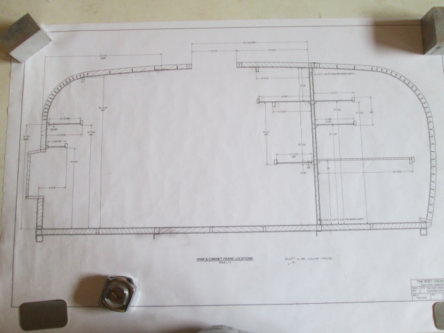

Added another sheet to the drawing showing the exact locations of the ends of the cabinet and shelf frames, the ledgers at the "backs" of the cabinet and shelf floors, as well as the roof spars and butt joints in the ceiling skins.

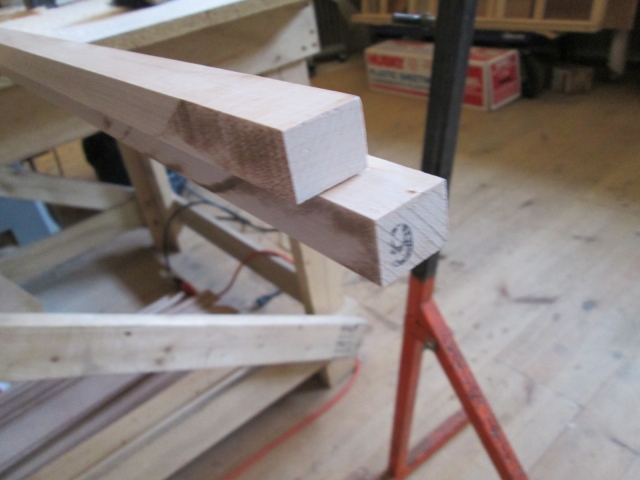

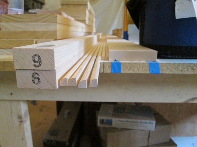

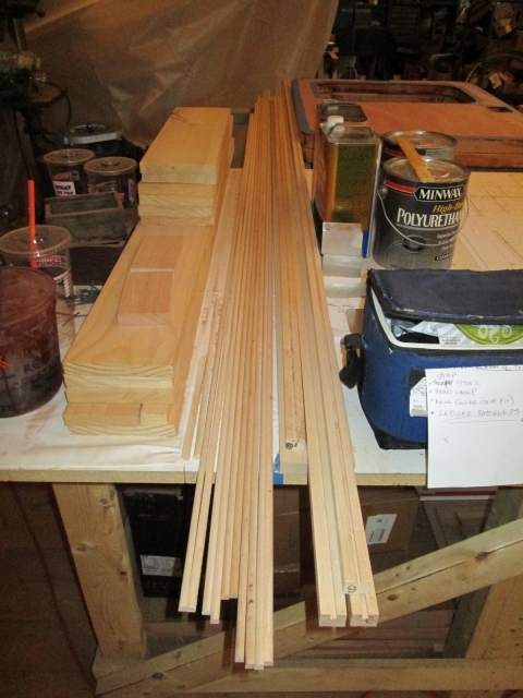

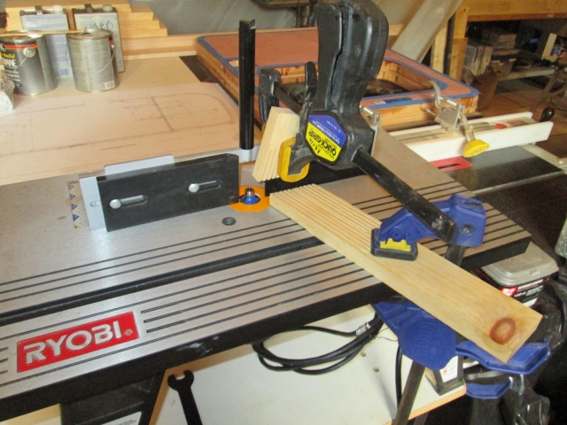

Today I milled up a bunch of maple trim and the ledger stock for the backs of the cabinet and shelf floors. Same technique as before: round over the corners on one of the narrow edges of a 1x2; groove between the rounded corners on the table saw; then rip the two corners off on the table saw. Here's the router set-up.

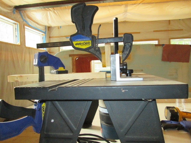

After I clamped the router table to the work/out feed table I had to cock the fence so that it was aiming into the doorway of the camper, else wise the 9 ft stock would run into the foam walls.

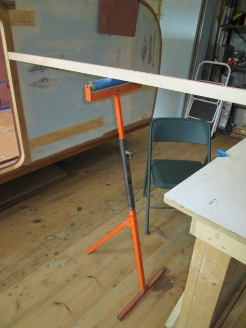

Borrowed this extended roller stand from Karl to match the height of the router table up on the bench. (Although I wiped the shop grime off of the roller, I still covered it with blue tape so that it would not soil the wood.)

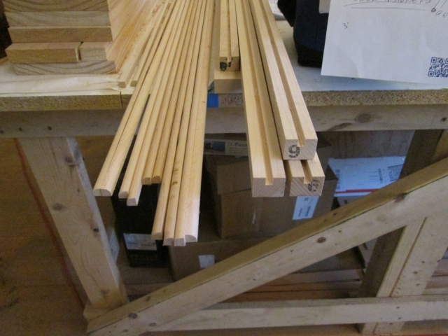

I needed 4 lengths for the grooved ledgers, but probably won't need twice that many piece of the quarter round, especially since I already had 2 lengths from when I made the little front rib blanks. On the other hand, the ledger blanks are only 15/16 tall, so rather than have a bunch of drop strips that would be too small to run thru the saw later, I just made a bunch extra of the qtr rnd. I might want it in the end.
Here's the start of it.
It is actually 5/16 on a side with 1/4 round over.

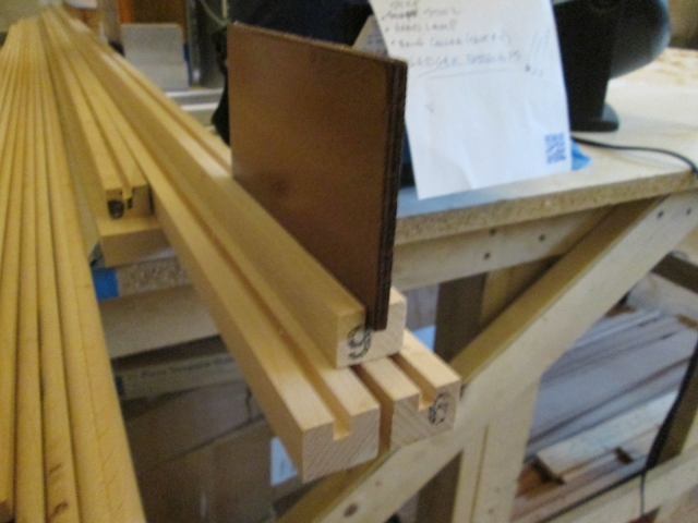

After ripping off those, one more thin little rip in the table saw yielded the blanks for the ledgers.
Next I ran the slots for the shelf and floor bottoms.
Test fitting the 5mm.

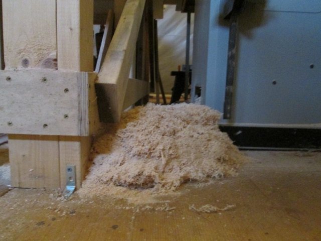

After a pretty full day, it was time for some cleanup, including digging out the bottom of the table saw cabinet.
That was only about 1/3 of what I eventually pulled out!!!

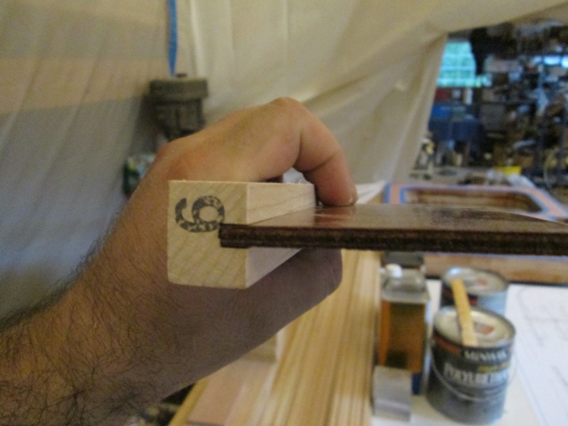

Did a few mockups with a chunk of the ledger stock and the screws I had bought. Tried a few options for were to place the screws. The finish screws have small tight flat heads on them that could fit over, under, or down into the grooves in the ledgers. Down in the groove was the tidiest because the screw heads would be hidden, but they would be too long and would risk poking thru the other side. (Now that I think of it, there may be ledgers on opposing sides, so that might work okay!)

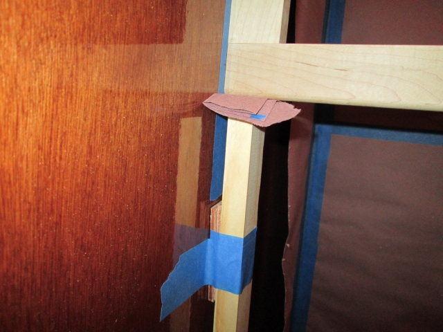

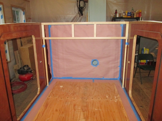

I ended up chatting with Karl for a bit while making up some temporary story poles to help set the cabinet frames and ledgers at the rear of the cabin. Fussed with that for a bit getting it right.
I taped some shims to the story poles to match the toe board spacing, and taped them to the walls to hold them in place while I dry fit the upper rear cabinet face frame. Some more tape on the walls for some marks to locate the lower front, and a couple of marks on top of the walls for the upper portion. In this pic it is just sitting on the poles and pinched in place between the walls, but later I ran 4 out of the 6 Kregg screws in just to hold it in place while I do some more dry fitting.
Here’s a closer look at the setup; used a few layers of the rosin paper as a shim to get the top of the frame perfectly flush to the top of the wall.
Due to the curve of the roof the rear edge of the frame was just a hair higher than the profile compared to the front. Just a slight shave with the matchbox plane and a little sanding, and I had it dialed into the profile. Curb side.
Street side.
Then I marked the outside of the walls so that later on when I put the ceiling skin on I can chalk a line across and screw down into the top of the frame like a spar.

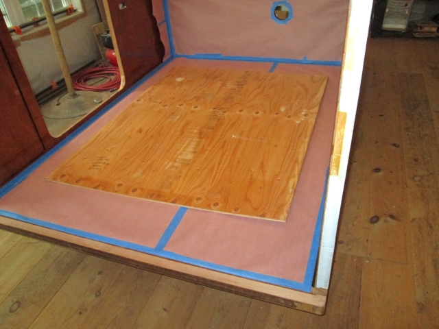

When I went to pull the paper and tape off of the bulkhead so that I could temporarily mount the lower rear cabinet ledger some of the poly peeled off with the tape. :x
I also needed to pull the tape off of the toe boards so that I could mount the Wiremold chases before starting to pull wires. More poly came off. :x :x
I did manage to get the ledger placed and the red light wire hole drilled, and spent the rest of the evening (Thur.) pulling the tape and paper out of the galley to get a handle on just how far this tape trouble was going to take me. Some pretty good sized areas along the curb side rear of the bulkhead were disturbed. :x :x :x
I think the poly must have still been slightly soft when I put the tape down (although not perceptible to the touch at the time). I'm sure I did a thorough job scuffing between coats, and it seemed to lift right down to the wood grain, as opposed to just taking off a top layer. Lesson learned: Take the number of hours drying time on the can and multiply it times days! The parts that had been done earlier had much fewer issues with the tape.
So tonight, rather than starting the wiring, I put masking tape on the adjacent areas (to guard) and hit all of the trouble areas with 220 grit. The poly was hard enough now that I could sand it back fair. Of course I sanded thru the stain in several places, so I hit these areas with the stain again. Added benefit was that the stain helped hide the grey color of the PL where it was peeking out in little whispers.
The only tape left is on the floor, so I may have some more spot repairs to do when I pull that up later.
Many of these trouble spots will be hidden in the final build, but I want to make sure that the wood is sealed up good, so I need to go back and lay down at least one more touch up coat of poly on these spot repairs before moving on.
