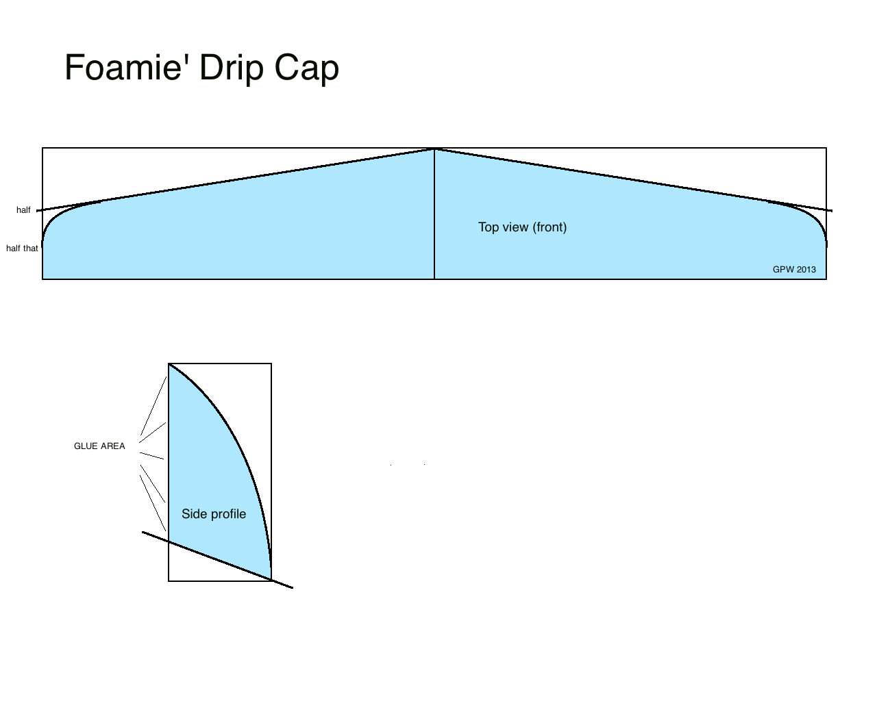

Mary, Going to glue it on with T2, and some skewers for “insurance” ... 2” Thick foam , 4” high X 36” long ... made from scraps (joined in the middle )

Up early only to catch the rain ... so inspired, I did a drawing of the drip cap ... Pretty simple and should be really effective on Foamies' ... with a distinct possibility for some artistic interpretation ... Make it as Fancy as you want ... Hmmmm? :thinking: Great way to use up some of those scraps (I hate to throw foam away ) ...

Did you not put a lip on top to contain the water and force it to the sides? That would not only keep water off the door but also keep it from running onto anyone entering or exiting.

:o Oh well .. people can get wet but the door will be nice and dry!!! ... :D :lol: :lol: :lol:
Re: FoamStream...
Postby Bogo » Mon Jul 22, 2013 7:58 pm
linuxmanxxx wrote:Did you not put a lip on top to contain the water and force it to the sides? That would not only keep water off the door but also keep it from running onto anyone entering or exiting.
I was thinking of a lip/channel, then gargoyles for the spouts to direct the water away from the sides of the TTT. :D What he has will work too.
