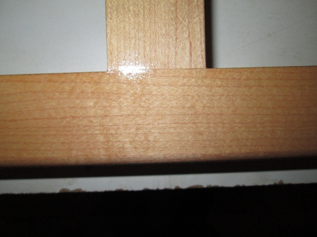

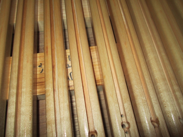

Thanks guys. I was just wrestling with doing the finishing vs. gluing. I tried to keep the glue areas free of oil and poly, but did not do anything to mask them or prevent incidental slobbering.
Forgot to mention that I spent a good deal of time last night hand sanding all of the ledger bits and pieces with 220 grit on the small block.

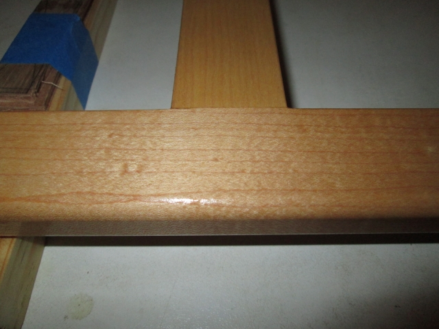

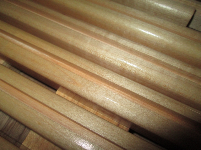

So tonight I propped up the rear cabinet face frames and ledgers on some creepers/sticker wood and brushed on the poly. I was concerned about the high build poly gumming up and going on the little parts too heavy, so I thinned it 1:1 with spirits. It went on like water and I’m pretty happy with the results so far. We’ll see how many coats it takes; I might not cut it quite so thin for the next coat.
I prioritized the cabinet parts for the rear of the cabin because I will need those for installation first and I didn’t have enough layout area to do all of the cabinet parts in one go.

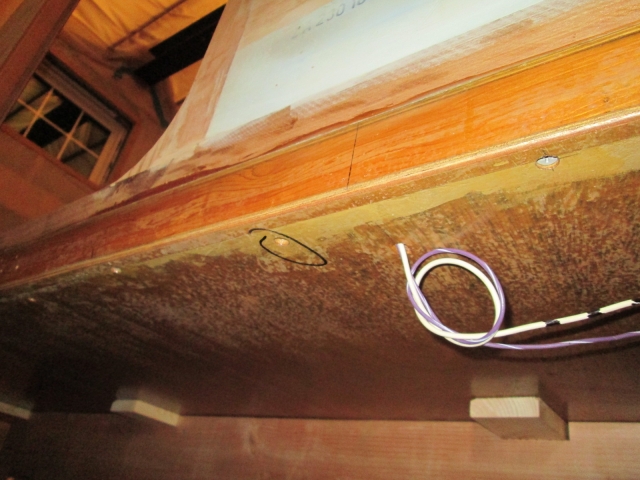

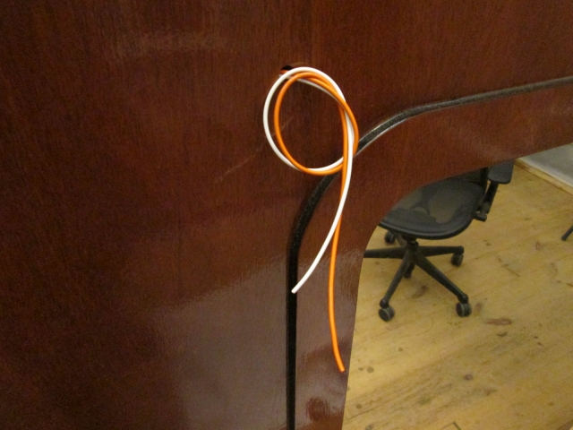

While that was drying I turned back to the cabin to continue with the electrical rough in. Got the porch light wires in on the street side.
This is under the floor looking up at the foot light wires that will be tied into the porch light circuit.

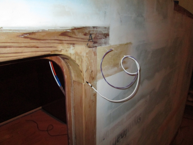

And the street side dome light wires.

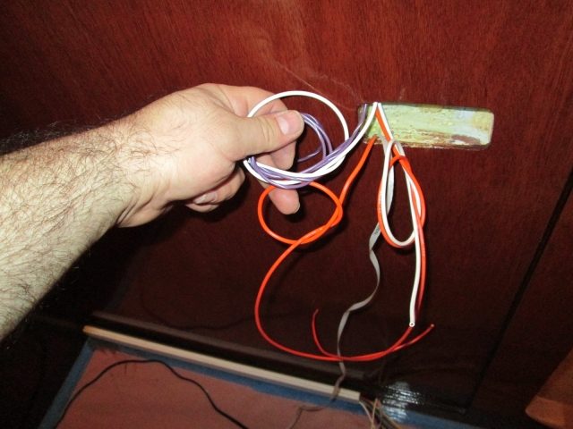

This is the street side main switch recess. From left to right: purple is the switched porch and foot light with white GND; orange coming up is the hot feed for the street side lighting (except the pillow light is on its own circuit) and the red light (I still need to pull the white GND from the baseboard up); and going up is the orange hot and white GND for the dome light. I still need to pull the switched lead for the red cabin light up into the switch box. The grounds will tie together here and at the base board.

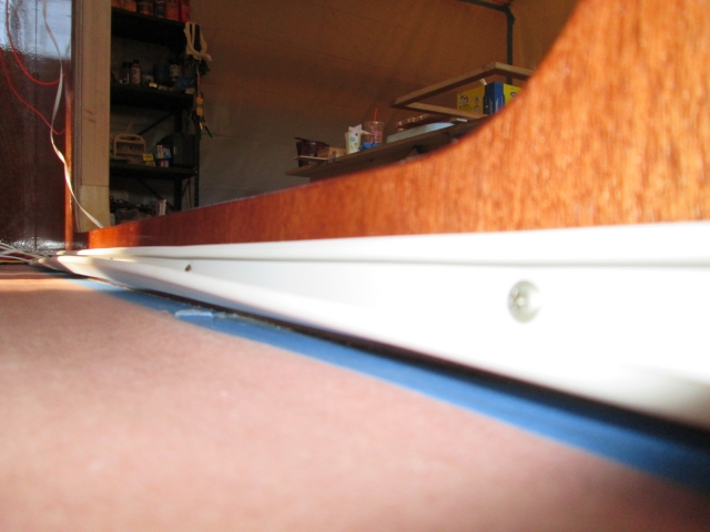

Pulled that common GND wire up to the switch box along with the main hot for the lights. When I made the splice for the dome and porch lights GND's I left plenty of slack so that it can be pulled down into the wall and the splices for the foot light and pillow light commons can be placed down in the Wiremold leaving slack to pull the first one back up into the switch box if needed. Also fished the hot lead for the street side pillow light, and will use that to pull the GND there as well.

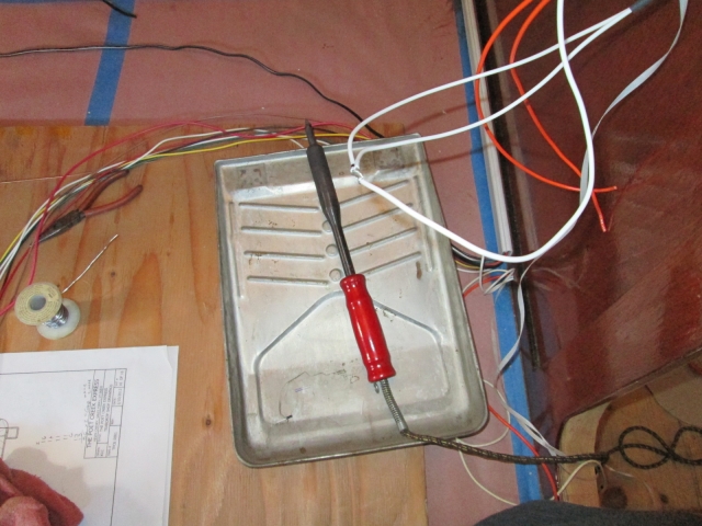

My big iron needs to either be hung from the eye hook on the handle, or be placed on a heat proof surface when in use (the spring type iron stands are too wimpy to hold it), so while working inside of the cabin I thought it was a pretty nifty idea to use the aluminum paint roller tray to rest it on and catch any drips of solder.

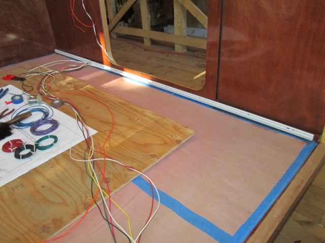

Next I fished the wires at the toe board from the switch box thru the back of the main section of Wiremold and stuck that in place, then screwed it down with the truss head screws.
