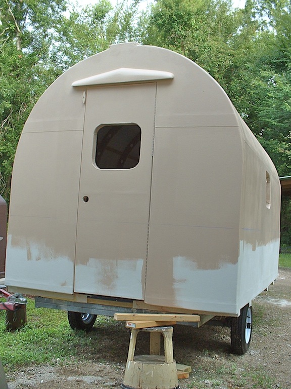

Got the door “stops" in ... all back primed with Gripper...have to finish painting it all before adding the rubber weatherstripping ...

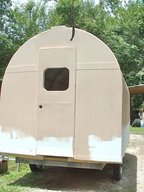

Baby’s first coat of paint ... :o

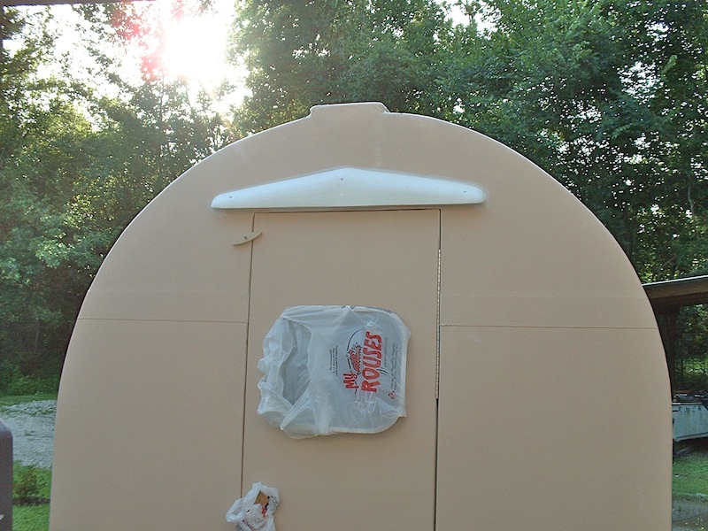

Hey , nobody’s Perfekt ... :oops: But I did just put it on ;) ... Have to caulk it later this evening ... Too HOT now ... Nap time !!! :D Everything baking in the Sun ... :sweaty:

Finishing up for the day .... Drip cap caulked , windows “bagged “ sorta’ a "dry in” (close ) ... And I have the trailer marked with a chalk line for the next color on the bottom ...

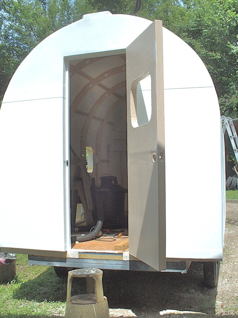

The door ... it fits well except a little tight :o I’ve traced the fault to the hinges which have no countersink in the screw holes ... The plan is to remove the door and hinges and drill the countersinks in them , which should give me an extra 1/16” -1/8” clearance , which will make the door fit “just right” ... :D

Did like Tac said and painted the second coat over all the window areas and inside the openings too ... :thumbsup: ... Painted the Drip Cap too , the caulk appeared dry from yesterday .
Drilled the countersinks in the hinge holes , re-fitted the screws (coated in bees wax ) and now the door fits Perfectly ... just needed that little bit more clearance ... ;)
