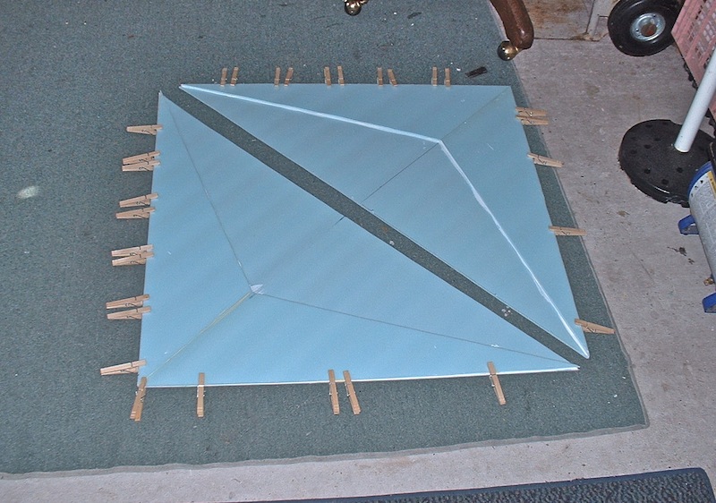

Postby GPW » Thu Jan 08, 2015 8:18 am
More long term Gripper testing : .... Using up the last of a gallon , we glued up some 1/4” aircraft (Blu) foam and laminated some pieces together, using the Gripper as the adhesive. This time , we clamped the pieces (Newton clamp) for 24 + hours, and then let it “cure ‘ flat for two weeks ... And I can assure you , the claims are true, those are NOT coming apart ... Naturally the foam fails before the Gripper. And while it may seem a long time to wait for something to dry for a little plane , it would be easily done for a trailer.. Given that trailers take months to build and finish (some even years :o )
We wouldn’t run out and buy the Gripper (or any other primer) specifically for this task , as TB2 would do the same job given the extended drying time , and for half the price ... :o But if we “had’ some lying about and didn’t want it to go bad in the can , then that’s just Fine . :D

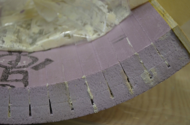

Sharing tricks from my build experience while working with foam and Great Stuff glue foam.
I needed to glueup curved panel that was previously kerfed. I decided to use GS for its light weight, same density, lower cost and good adhesion to foam.
As a result of trial and errors on sample (and non-sample :x ) bent glueups, I came up with these items to make for a better curved foam wall panel:
1. Plywood edges were glued (w.TBII) to make a consistent bent along the panel length and assemble the panels together. They are light, 1/4" thick and contribute to a stronger wall structure.
2. Custom clamps. I premade a batch of plywood brackets like these so they can be screwed on some scrap lenghts of wood to position the curved panel both edges at precise required angle. It is very quick now for glueup clamping or rather "clicking" in place.
3. Packing tape placed on foam. I did it after the kerfs were cut which was a bit of work. Next time I plan to put the tape and then cut kerfs.
4. Great Stuff canister tip *modification* or simplification.
I simply removed the stock plastic tube from the plastic adapter on the can and this simple trick made the placing of GS in the kerfs SO MUCH EASIER, cleaner, quicker, and in a right amount. You'll wear gloves, right? :oops: ?
5. The glueup result: no sanding is needed.
Panel is clean off GS, nice and straight.

Re: glue info for foamies
Postby Wolffarmer » Sat Apr 11, 2015 11:02 am
Wow, cool. Many thanks for the tips
Postby OP827 » Sat Apr 11, 2015 11:29 am
You are welcome Wolffarmer. I got many good ideas from you guys, so thank you for being here! George gave me a lot of inspiration ideas, thanks George! This is how clean the second panel just came out.
