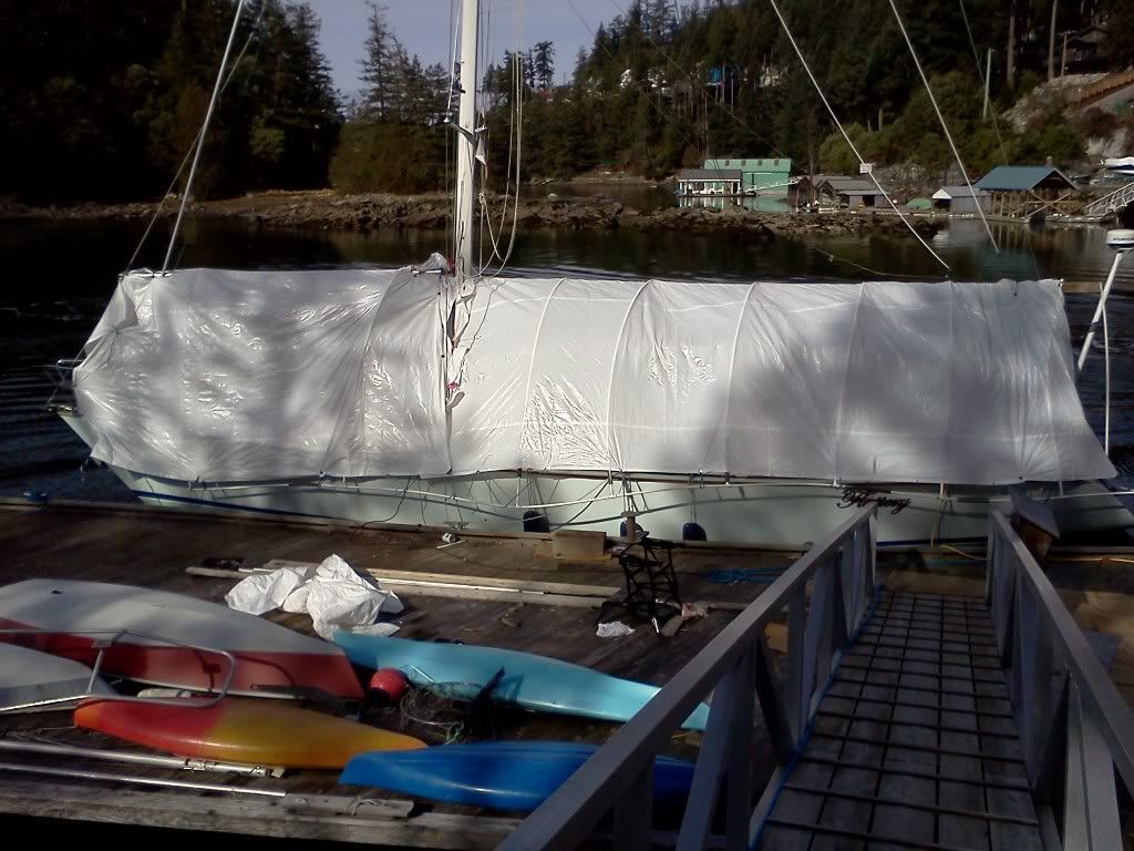

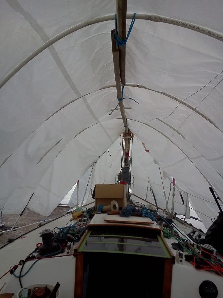

Just a quick thought re conduit ribs...
I've done something similar for covering boats in the off season. Right now I have a work cover over a 48' sailboat that looks a bit like a covered wagon. I would think that, for our purposes, 1/2" Sched40 pvc would give you the rigidity of the frame AND the flexibility to bend into a horseshoe. Another option would be something like 3/8" PEX. Fittings can also be added to give you longitudinal stringers as well, stiffening the frame by creating a cage. It will also keep the weight and cost down and can be worked with almost no tools or skills.
Edited to add pics:
This was this morning after 90km/h winds most of yesterday. The section by the mast acts as a 'fuse' and blows out to keep from shredding the whole thing...which it did admirably. I would have no structural concerns whatsoever covering this with foam to make a trailer body.
