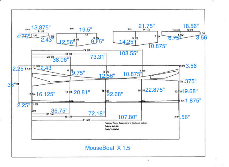

Time to get started on the Foamie’ boat !!! ... I have the mouse boat plan and would like to make it -12’ long and < 48" “ wide ... Guess the easiest thing is, to draw the plans out on kraft paper full size on the floor , and use a scale factor (150%) for the larger size needed ... :thinking: Since foam’s homogeneous (and will be covered with a skin) , it should be no trouble to just butt together foam material for sides and bottom > 8’ long... laminations will stagger the splices.
Thinking we’ll likely use 1” foam and then double that with a lamination of another piece of 1” foam ... Properly skinned in and out it should be “strong enough” even for my “large frame” ... :NC ..

Postby GPW » Wed Mar 11, 2015 1:47 pm
Working out a simple ratio , a 12’ Mouseboat would end up 45" wide... Just perfect for putting in the back of the pickup truck . :thumbsup: 8) Big enough to include an electric trolling motor and a battery or two , and perhaps a rudimentary sail outfit ... something tiny just to take advantage of a good breeze in the right direction ... (golf umbrella might just work too ) :roll: Got my roll of Kraft paper out ... Going to draw all the parts out on the Kraft paper , then carefully glue the Kraft paper patterns to the foam (TB2) Then it will be easy to cut out all the parts with the patterns fixed to the parts... then (and get this ) we leave the paper glued to the foam , because #1 , it’s already there , and #2 , it adds a little more strength and possibly even makes the next layer easier to glue on , and as it dries , it shrinks slightly so may serve to cover over all those tiny dents and dings we normally get in the foam ... sort of a paper “primer” for the foam ... :thinking:
Every little bit of Strength built into a foam boat counts towards making it “seaworthy” ... sorta’ ... AARGH !!! :beer:

Here’s the calculations ... :thinking:

Postby tac422 » Thu Mar 12, 2015 9:04 am
Hi Doc,
How many 4x8 sheets of foam does that equate to ?
I was trying to figure out the layout from your drawing :thumbsup:

Postby GPW » Thu Mar 12, 2015 11:32 am
TAC, should be 1.5 times what it took to make the normal size one .... plus a little “fudge factor” ... I'm guessing about 3 sheets , plus 2 more to double everything ... Just a WAG though ... once it’s all drawn out on paper on the floor , we’ll have a better idea ... :thinking: My goal is to keep the whole project under $200 USD... Not unreasonable ... :roll:
The longest measurement is 144 in. ... (not shown for some reason) :o
