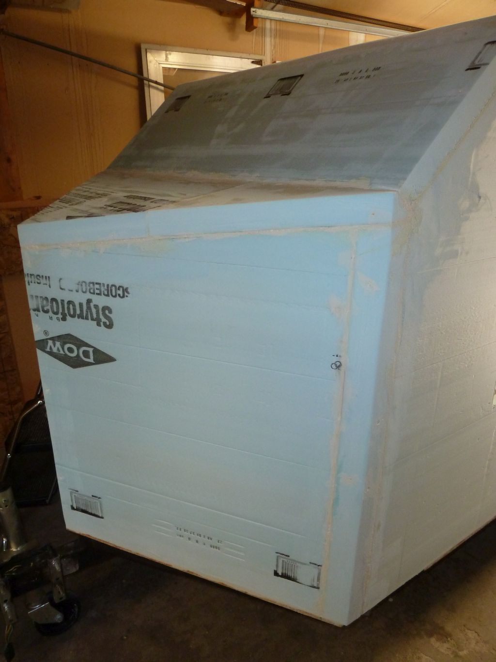

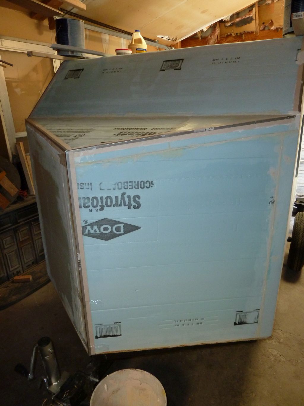

Postby Fred Trout » Wed Jun 24, 2015 4:54 pm
Finished the rough sanding & caulking. Ready for flashing, corner bead & spackling.

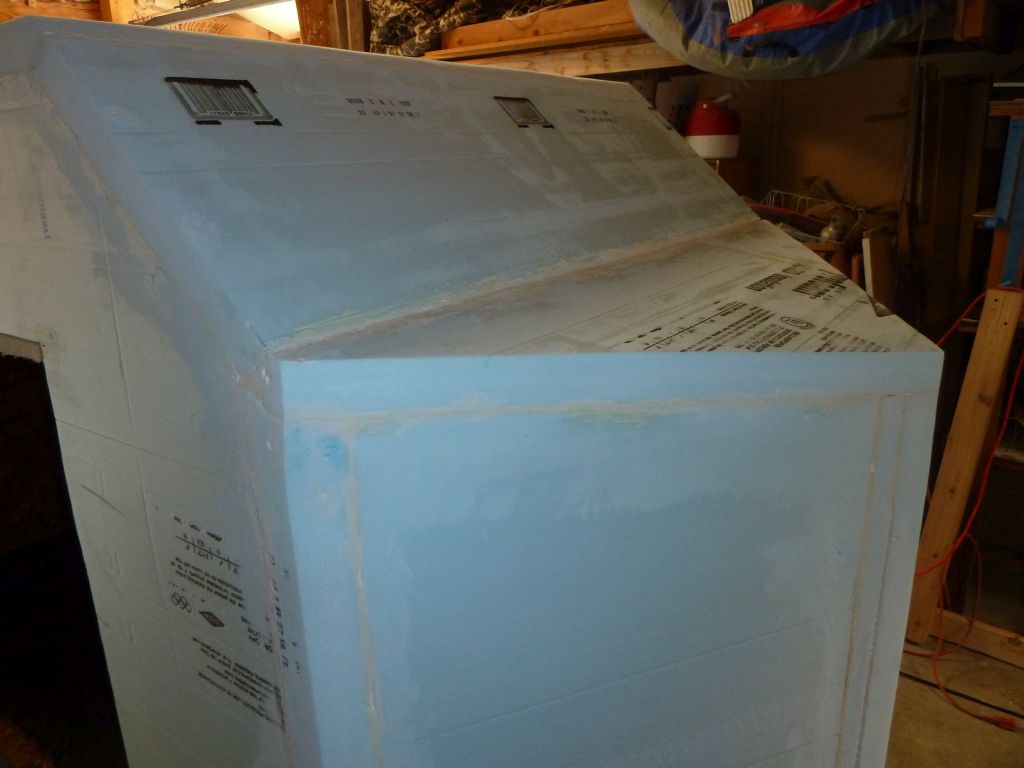

Postby Fred Trout » Thu Jun 25, 2015 3:28 pm

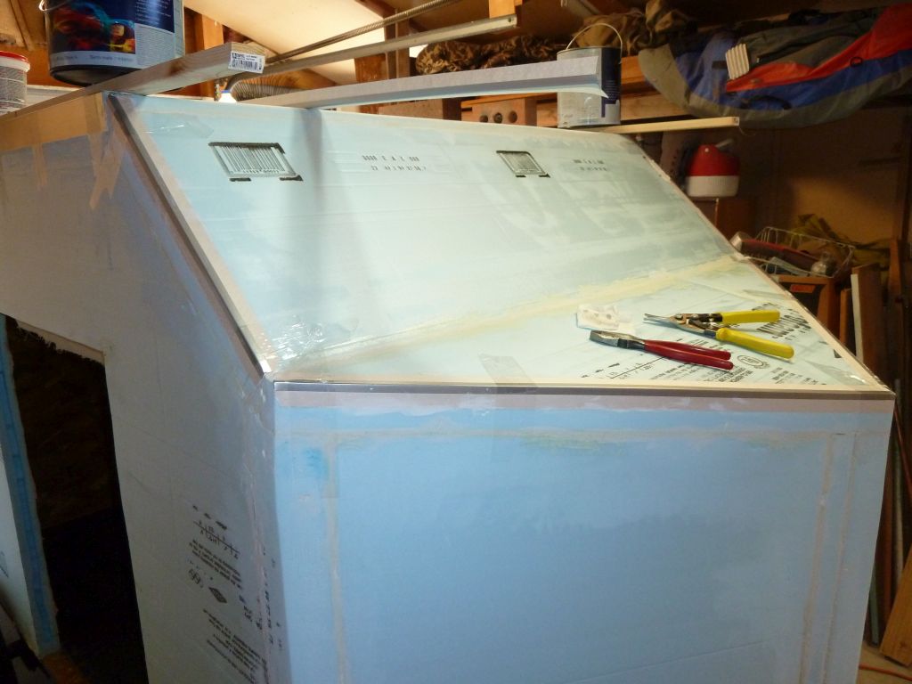

Installed flashing & corner bead - might need some more but most is done. Used Gripper & GS for 2x2, Gripper or TB II with paper backed corner bead. My usual crooked job :cry:
Should work for all that.
EDIT: 2x2 flashing will be used as mounting points for things like awning rail or solar panel / roof rack but the car has a roof rack and probably a better idea to mount stuff to it instead.

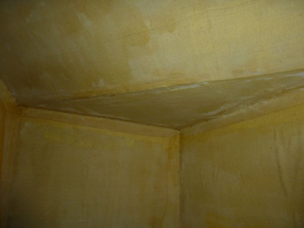

Postby Fred Trout » Sun Jun 28, 2015 7:44 pm

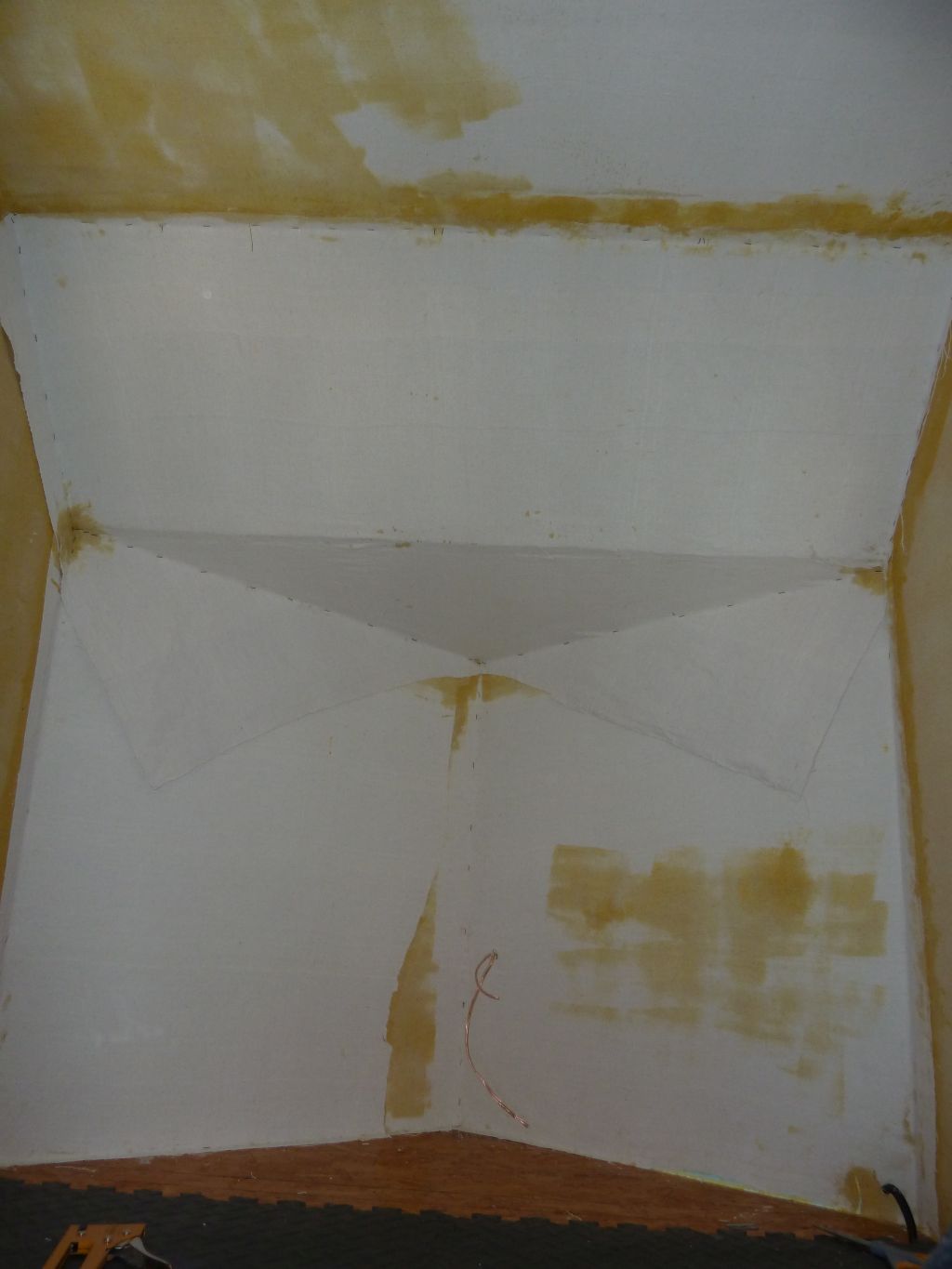

Finished applying the canvas to inside front except for trimming the edge excess with a razor - just got way to hot to work anymore but I should have it done tonite or tomorrow if it does not cool off by dark. Note the use of staples to hold the canvas in place - much easier to do what you can on the flat. I added a small bit of overlap on the floor edge but will be adding 2 - 3 triangular shelves that should stabilize the front shape even more.
Will apply watered down TB II to rest of interior canvas tomorrow and do some faring on exterior if I can before it gets too hot. Today was in the mid 80s by 10 AM :x Not used to the heat at all after decades in the refrigerator box called Montana. 8)
EDIT: note the wire loom - bottom right - covering the wiring going into the wall for the front USB & Auto-lighter outlet & Outside Front LED fixture - a 1/2 depth single gang box will be applied to the wall surface under the bottom shelf where the 2 wire ends penetrate the canvas.
EDIT2: finished trimming the canvas and rolled a coat of diluted TB II over the canvas for dent resistance. Interior is ready for shelves, final paint, & electrical.

Postby Fred Trout » Mon Jun 29, 2015 10:42 am
The paper covered corner bead is nice to work with but I don't know how it will look when covered. The 2" flashing has lots of small deformations that did not glue down well that will make the faring more difficult. I think I should have been more selective when picking out the pieces since one side is much better than the other - the stuff deforms easily when handled.
Have no idea how either will look and perform when covered but we will find out one way or the other. As said before, not making a work of art, just a tent on wheels so either will do fine as long as they keep the weather out. This is the last day of really hot temps 95~100 but summer is here to stay apparently for the next 10 days anyway. Too hot to work today at any rate but I did get the interior ready for primer last night. Will be adding wood to the door rough openings then lifting the TD & adding a reinforcing canvas strip along the bottom after 1st side fairing for my next big steps.

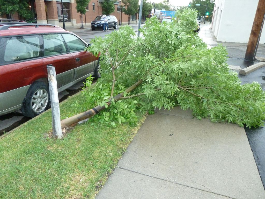

Thanks Mary. Thunderstorm just passed through. Went from 100 down to 77 in a half hour & blew over a few trees. Found out I had bubbles form on front canvas where I did not let the TB II dry before I put a coat on top. DOH ! Will try using an iron w/ steam to get it to sit back down. It's always something :D

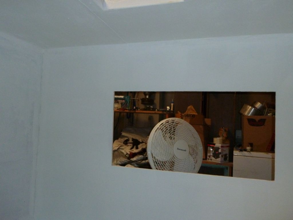

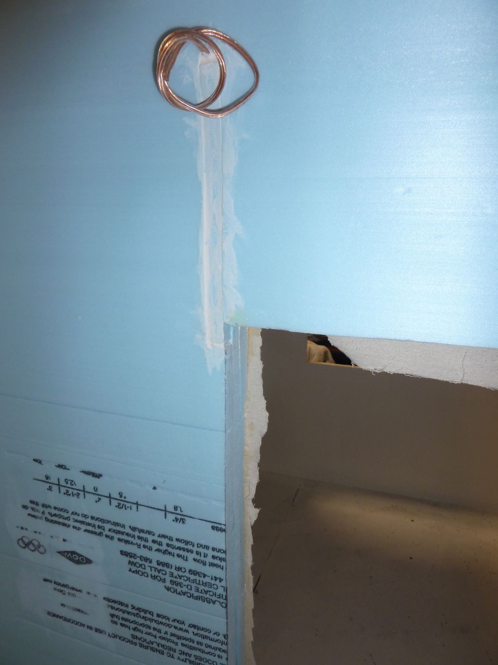

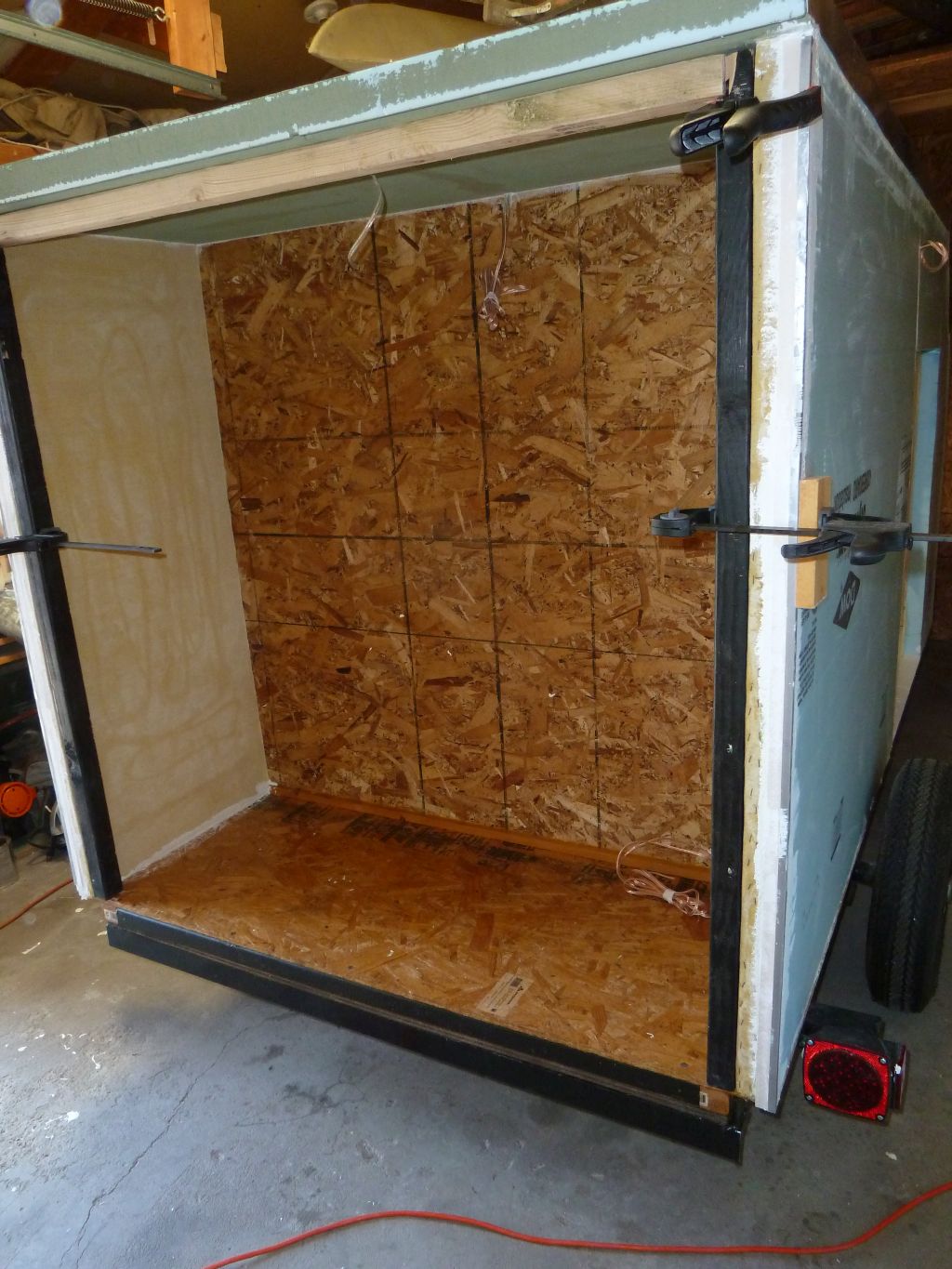

Finished painting Gripper primer on interior surfaces including floor. Finished rough cut of galley door frame & corner bead (more crooked to buff out). Finished covering cutouts for 'porch' wiring.
This afternoon & tomorrow, cut & fit door wood framing, glue in that and galley frame, 2x2 flashing on galley roof, exterior fairing. That ought to keep me busy :D
