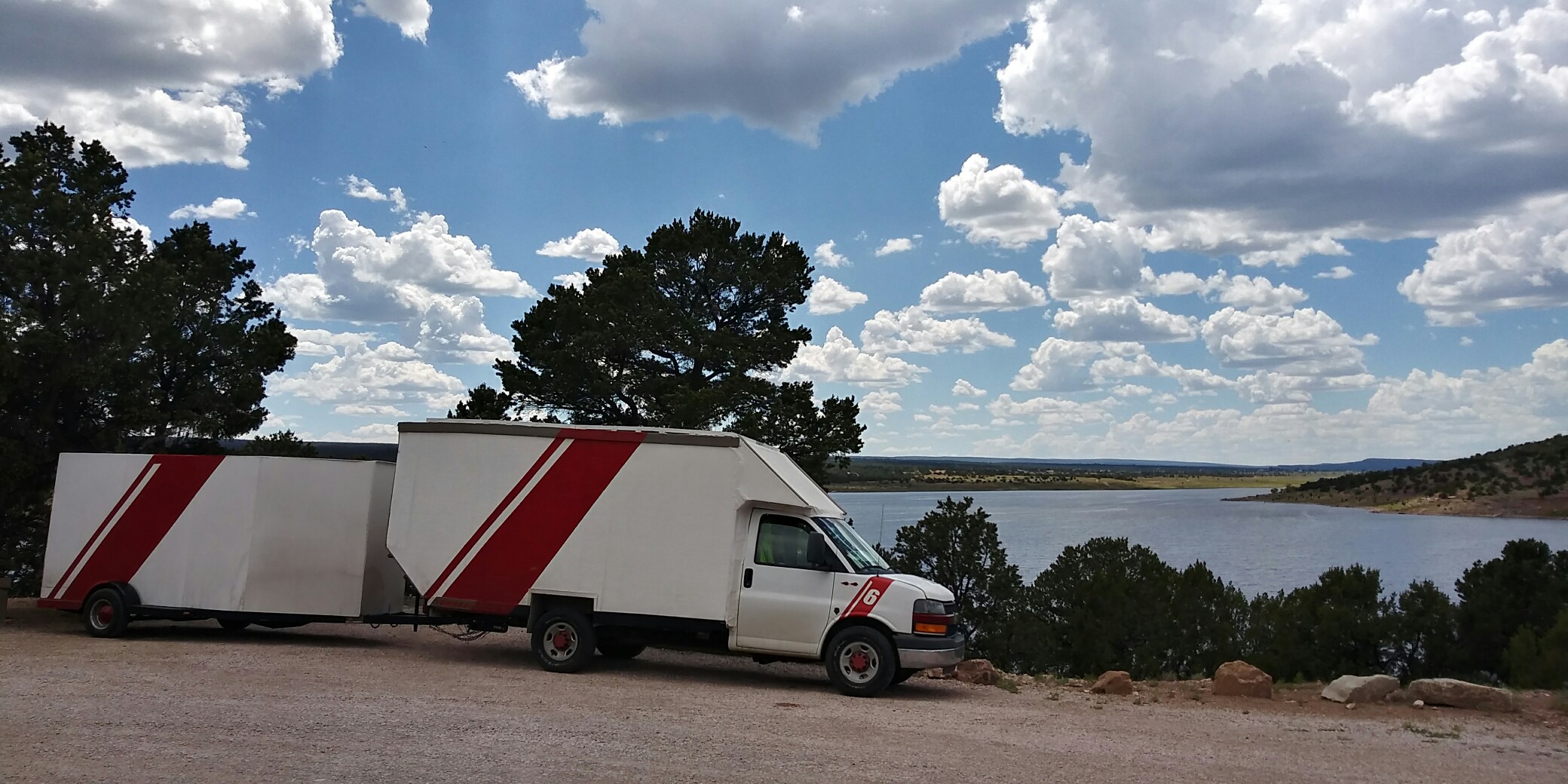

Postby Projector » Wed Oct 30, 2019 2:08 pm
So it's been about 1 year since built and on the road.
Approx 7500 miles, mostly highway at 50-70 mph, temps from 30-110+F, wind up to 40 mph gusts.
Constant Southwest sun exposure for up to 14 hours per day with barely any rain. One possible hail storm but I wasn't there at the time.
And the oversized backpack beer cooler has survived without an issue. So far. So good.
Interior temperatures have gone up to 95 with 110+ outside and down to 45 with 30 exterior. The insulation is effective as expected. And takes longer to cool or heat accordingly back to ambient air temperatures. Life is compromises.
It has allowed me to explore and travel as designed with solar power providing for my power needs.
Managed to get out and weigh the rig.
Starting with a 6600 lb base weight before build, any guesses as to current loaded weight?
Would you believe 8900?

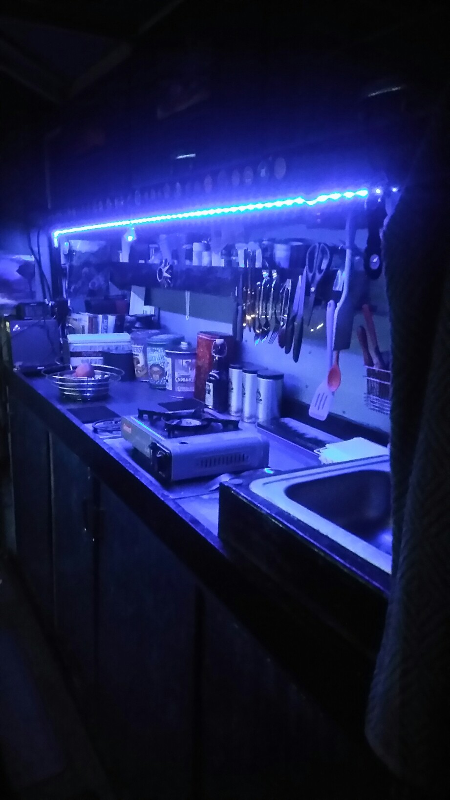

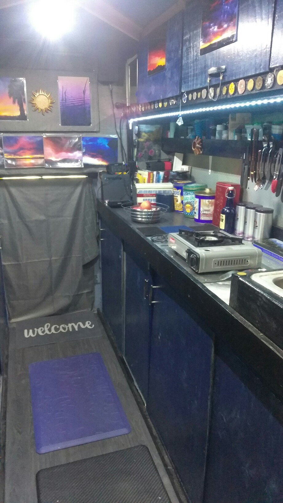

Postby Projector » Fri Nov 15, 2019 10:23 am
So far so good George.
As promised, couple pics of where it's at now.
Here's the kitchen galley and library.
Also comes with soft lighting for when a jazzy mood can inspire some culinary adventures.
Pics are of special moments experienced on my travels. Like to do a little photography to capture awesome sights to cherish for the future.

Re: TERRA6, Van cab and chassis 7*14, 4" Polystyrene
Postby Projector » Fri Nov 15, 2019 10:27 am
Some soft jazz, hands on food preparation, cooking aromas, glass of Merlot, sensual.
:wine:

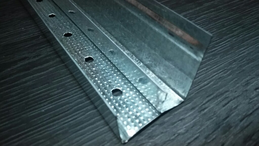

Postby Projector » Fri Nov 15, 2019 10:30 am
Homemade sliding tracks for the bottom slide doors.
J channel over drywall corner bead.
Low cost and effective.

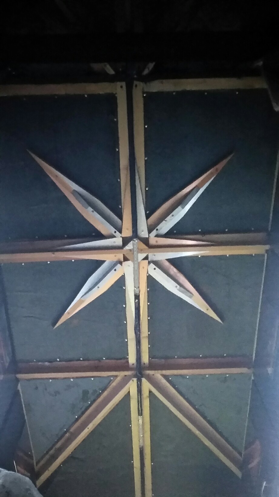

Postby Projector » Fri Nov 15, 2019 10:36 am
I've left most of the inner frame exposed.
Decided to use some leftover wood and incorprate architectural design, a compass rose.
Make it so.
