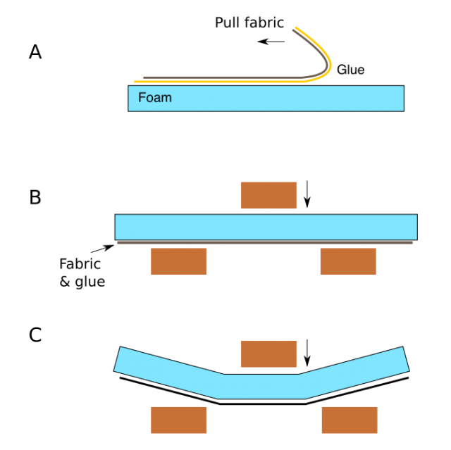

I am wondering if some of the testing of adhesives for bonding PMF is misleading.
The most common test is whether the fabric can be ripped off the foam where it was glued (panel A in figure). In some cases the foam fails and fragments remain attached to the fabric.
This does allow for comparisons of adhesives.
However, In no case I am aware of will a loose edge of fabric be under this type of stress. Instead fabric edges will be glued to wood or to each other making a continuous surface. There is no question fabric glued to wood or fabric is very strongly adhered.
The forces on the glued fabric/ foam structure will be produced by bending surfaces not ripping off fabric. The glue will have to fail by the fabric fracturing along the surface of the foam rather than fail along a much smaller zone seen with ripping off the fabric. Testing should apply forces parallel to the plane of attachment between the fabric and foam not perpendicular to it.
I am wondering if a better test might be what is depicted in panes B & C above. A portion of foam is covered with the test glue and fabric. A bending force is applied to the structure placing horizontal stress on the PMF layer until something fails.
    If the glue delaminates then it has failed the test.
    If the fabric or foam is damaged first the the glue is successful.
I suspect many glues/primers are going to work just fine in this test. The glue only needs to not be the limiting factor in this structure. Good enough is no worse than better.

tomhawk wrote:I suspect many glues/primers are going to work just fine in this test. The glue only needs to not be the limiting factor in this structure. Good enough is no worse than better.
I'm finding most exterior primers don't work well, yet that's me and my experimenting. One of the first tests I did was to see just how strong the bond would be on a angle. I took two pieces of foam, not glued, and did a strip enforcement on a 90 degree inside corner. The cheaper primers I was able to tear the sections loose. Now, all bent inwards fairly easily, yet with a better primer, it took quite a bit of force to break that connection, some I could not physically break. With both inside and outside of each seam/joint being done, and glued, it would surprise me if you could break it on an outward test with a good primer.
I personally see the tear test as important. It shows the bond in such a way that probably wouldn't happen in real life. I also believe that if you placed two pieces side by side and attempted to tear them apart, sideways, you'd find it very difficult and probably beyond human strength.
With that said.. It would e a good test for you to go through. :thinking:
Would love to hear your results.

Tomhawk … JMHO , this was a better test for our trailer needs … 79717

Jag, for me testing different paints (and TB2) I found differing results in just the peal test as in adhesion and stiffness. One would be material stiff, yet lost adhesion. When another would adhere nicely, yet felt softer.. I liked my Pro-Cryl from Sherwin-Williams (it is not cheap), it hit the balance of both. I see the peal test as a pretty good way of testing.
I do like TomHawk's test shown above. This is a great way of determining strength of the foam once covered.

Postby JagLite » Thu Jan 16, 2020 4:28 pm
Good points all. :thinking:
I looked closely at that picture and it appears that the foam did the job.
The sledge hammer wasn't damaged! :thumbsup:
