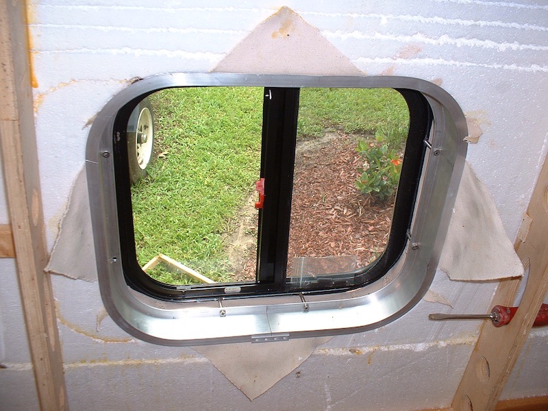

Gee, these windows are a real “sphere buster “ to install :shock: The trim rings supplied are too shallow and the Frank the Bear’s “you can make it work” just ain’t happening ... :thumbdown: Huge 1.5” gap between ring and window ....Looks NASTY !!! What The (your word here) ??? I’ll NEVER order these again ... in fact I’m almost ready to chuck these into the woods and just call it a bad experience... grrrrrrrr!!!! :x :x :x

Seems some pics and I'll tell you how to get them to work. The rings are for certain defined thickness and I had to shim every door I installed

I don't know about trailers so much but in boats it's pretty common to have a gap between the trim ring and the flange extrusion. Line the opening with a strip of roll flashing (paintable) or a strip of wood veneer, then put the window in. When you're done it'll look like it belongs there. In your case, even a strip of canvas painted the interior color would work great. I'll see if I can dig up a pic for you, though it'll be a scan of a 35mm print.
Will the trim ring work better if you flip it around to increase the clamping distance ?
Also, you can dress up those exposed screw threads with a bit of brass tubing or even black heat shrink.
That's what makes those windows adapt to any wall thickness - it's a blessing, not a curse !!

W2, the 3.25” trim rings he advertised , but was out of :roll: would have been Perfect , Nice and Neat ... maybe it’s just me , but I hate when things don’t fit right and you have to “X rig it “ We used to install windows in Vans all the time .... they all fit straight away ... :R

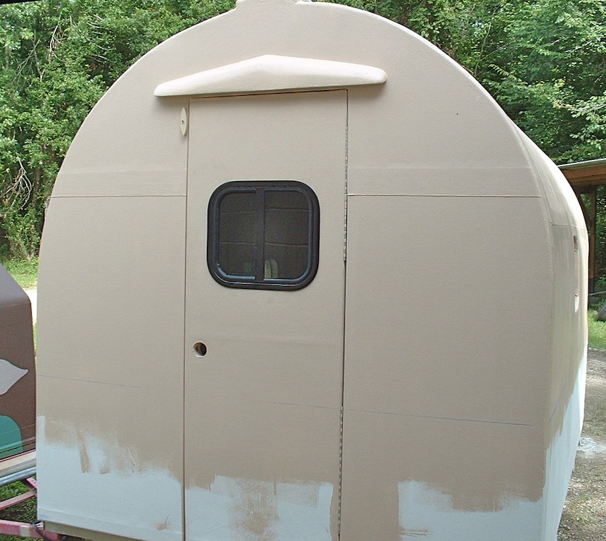

Fought with the windows , but eventually we got them in ... 8) (maybe a bit crooked , had the wife make sure they were straight while I tightened the screws , a sure sign they must be crooked :R ) Added the rubber weather stripping to the door stops ...
End of the day , all dried in .... finally !!! :beer: :beer: :beer:
Tomorrow , we tackle the bubble on the other side :frightened: ... I was thinking of opening the seam above the window and just spreading some T2 around... Skin surgery ... and only on one side ... :roll:

Postby KCStudly » Wed Jul 24, 2013 7:23 pm
Looks good from my house. :thumbsup:

Looks great from this perspective!

This little door closing mechanism... I hope it is temporary. Otherwise, you might find yourself trapped some day. :shock:

Cliff , door tab IS only a temporary till we get the door lock in (soon) :thumbsup:
