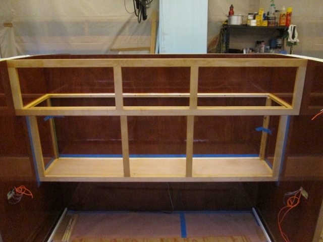

Here are the pics from last night.

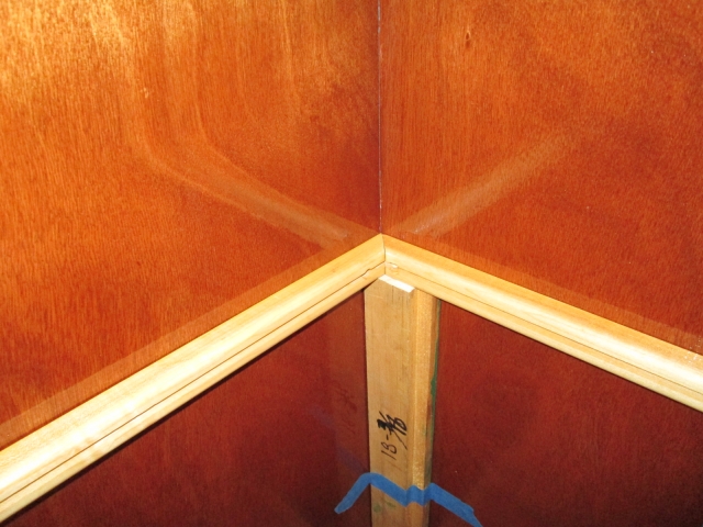

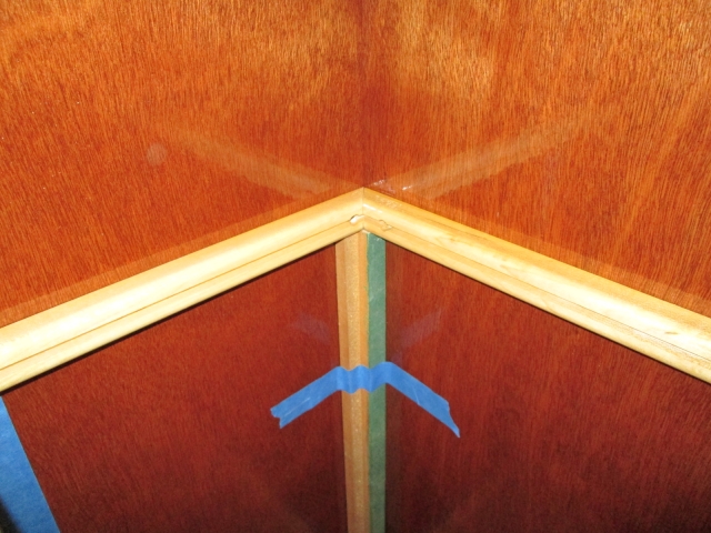

Temporary spacer stick in corner aligns the upper rear side and rear cabinet ledgers.

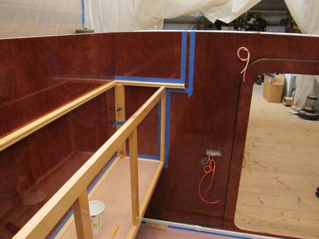

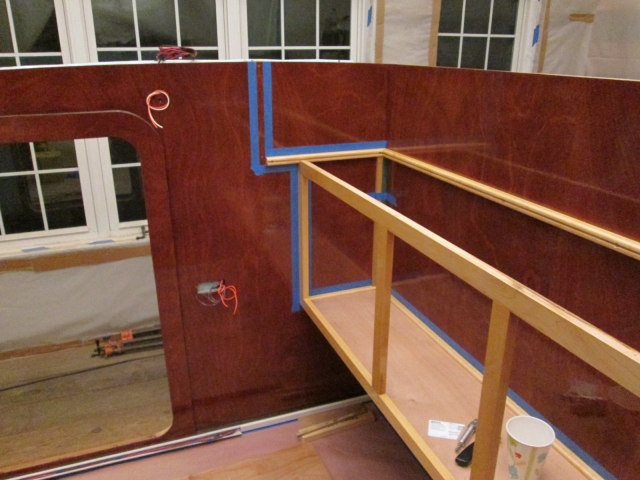

Had to trim the rear ledger bit by bit until it fit just right. Here is the street side.
An overall shot of the dry fit.
Here I have completed masking and taken the upper cabinet face frame back out so that I can start fitting the upper cabinet floor panel, and have easier access to mask the upper rear ledgers. Curb side first, then street side.
I dug the panel “out of inventory”. Had to clean some dust off of the edges where it had not been covered properly; there is some slight shadowing that will mostly be invisible after staining and who is going to stick their head inside of the cabinet anyway? This panel will need to be trimmed to length and ripped down just a bit due to the switch from 1/4 round to the slotted ledgers.
