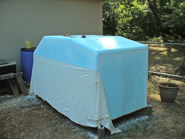

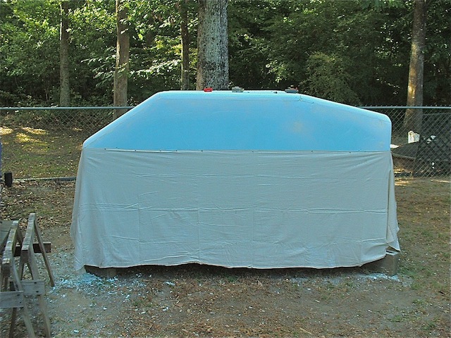

\GPW wrote:Eagle , I have tons of canvas , but it's all too narrow ... (36")![]()
So a patchwork will be the ticket !!! Trying to lay out all the seams symmetrically ... just so it will look right ... Hence all the measuring , marking and dry fitting ... Easy if you have one BIG piece , just throw it over the trailer and have at it ... But I don't ...Being a Thrifty project , the plan is to use "what I Got !!" Besides this is a Linen canvas and much stronger and more durable than the cotton ... and actually pretty expensive too ... so it should work just fine and provide a nice textured surface to paint on , as much as when I use it for oil paintings ... With the strip shown in the pics , the plan is to start at one end , gluing and aligning my way to the other end ... repeating the same procedure around the structure... Then overlapping the top piece over the bottom piece by 4" .. That should not only look "even" but actually add a little extra strength around the "belly" of the shell ... like a band or belt ... every little bit counts when the bears are out ....
