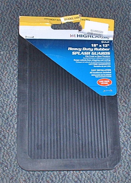

The mudflaps are nice ... Heavy duty , look to be 1/4” thick ... couldn’t beat the price ... these should last a good while , and do the job ... :thumbsup:

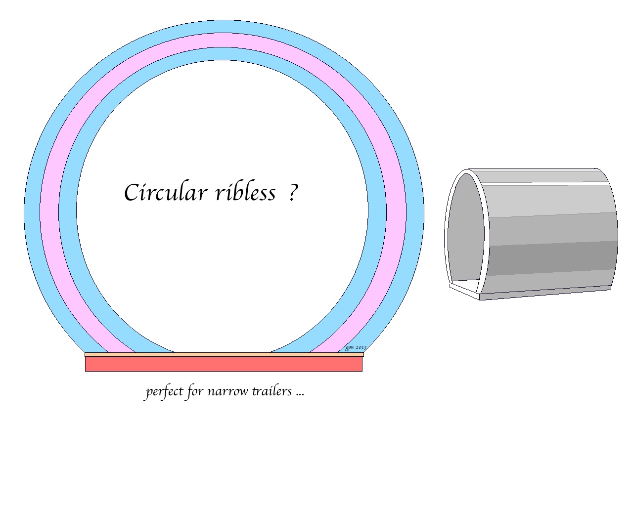

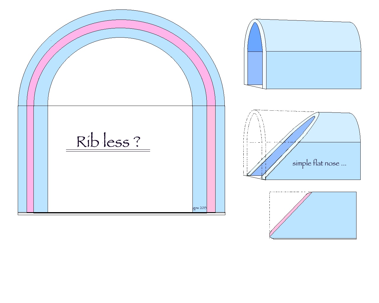

Ribless... once we figure out a “home" method for bending foam with heat ( not requiring large expensive tools and forms ), , many shapes should be possible ... No ribs necessary as the tubular shape is very strong by itself ... Once the foam is heat bent it stays in that shape ... All yet to be experimented with as yet on trailers ...the plane guys do it all the time ... :o ... Bottom line , the Less wood (especially plywood) the less problems later ... ;)
Vinnie and I have been investigating large “heat blankets “ , thermostatically controlled to produce the exact heat for perfect foam bending and forming (~190F) .. seems the easiest way , and not That expensive, especially if constructing multiples ... I’m still being pressured here to start a “business” making small affordable EVAC trailers ... It would be quite popular here... everyone still Paranoid from Katrina!!! :frightened: But it took a long time to get Retired , and I like staying retired ... May end up just be a “consultant” ... I could hang with that ... :beer:

Cliff , I kinda’ like the ribs too as a place to hang and attach many things ... “hard points” and holes all over the place ... and for we old people a good place to grab ahold to steady oneself .. :FNP :lol:
Just a couple of my thoughts about ribless... multiple thickness of foam , bent and the glued together as one ... 2-3 layers of 2” foam should not only be Very Very Strong , but keep the Beer COLD too with minimum effort ... :thinking:
