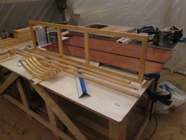

Second coat of poly on one side of rear cabinet panels, and first coat on all of the front cabinet frame work. I screwed “feet” to the top sides of the front cabinet face frame (using the Kregg pocket screws as for installation) so that I could stand it up and get both sides at the same time. Put painters tape on the tops of the cardboard corners to keep the small parts from sticking.
