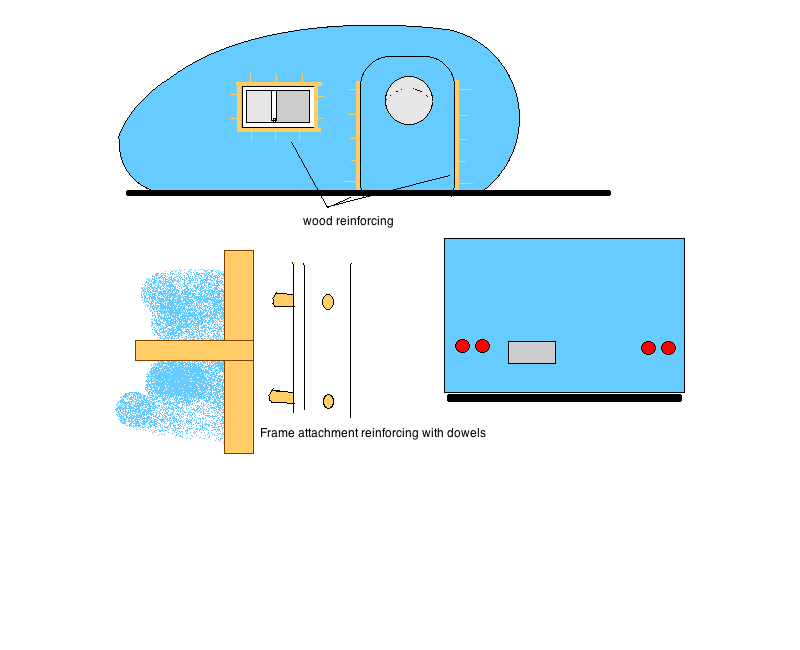

Ok , so how about something like this ...canvas or T-shirts/etc. over just the 2" foam insulation ... doubled 1" on top for easier bending (Heat gun makes it simple .... blue foam bends at 190F... stays that way . ) Image
Wood framing for doors and windows ... everything glued in ...shell glued to floor , reinforced with fabric doubler strips ...
Seems pretty simple .... some folks might want something a little more substantial , and so could add thin ply skins outside and in , then the canvas ...

Ageless , I was thinking the standard style (TD) would be stronger than a box style in bent foam (That curve thing ) , plus the aerodynamics would impose less wind loads on the more streamlined shape ... easy to add several layers of foam to the roof to make it as thick as you want ... water based contact cement works best for this as the other ones we've tried tend to gas in the sun eventually and actually melt the foam a little ...grrrrr!
Anyone have a ballpark price for a sheet of 2" thick Blue Dow foam ... it's much stronger than the white EPS beaded foam , and comes up to 4" thick ... :o That would be some insulation factor eh ? ... Guessing we could easily approximate the cost of such a build , depending on how many old T-shirts we have left ... :lol:
I feel the need to make some more drawings....ideas popping ... be back soon ... :o :o :o :o :oops:

More ideas ... Image
