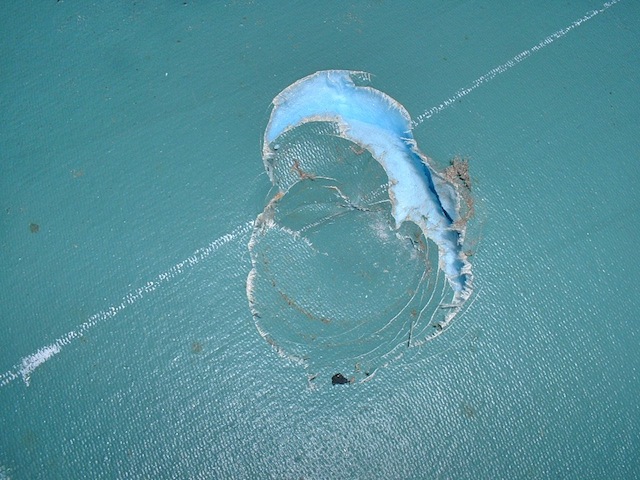

Postby Conedodger » Sat Jun 11, 2011 5:19 pm
mikeschn wrote:I'm playing with epoxy this morning!
I've used epoxy on fiberglass and canvas!
I have to let the resin harden overnight, so I should have some preliminary results tomorrow morning!
Hi Mike.
Pods8: who is a member on this forum did several tests
http://www.expeditionportal.com/forum/threads/58926-POD-Homebuilt-foam-core-fiberglass-skin-pop-up-camper-build-thread?p=860140#post860140
Thought you might be interested, i would be interested in similar tests of TB2 and cloth if you fancy doing some. So far no one had bashed a TB2/cloth panel to see how it compares.

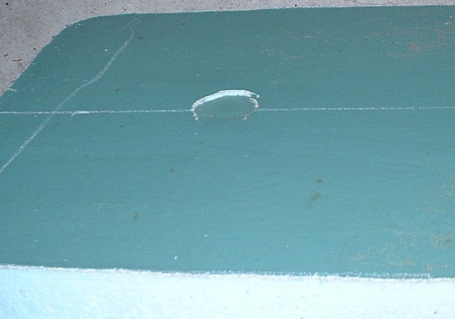

Postby GPW » Sat Jun 11, 2011 6:12 pm
Here ya' go ... 16oz. hammer Gave it my best shot ... Image
Surprisingly the hammer only dented the foam about 1/4" No cracking ,splitting ... damage was localized to the immediate impact area... Would be an easy fix ... Heavier weight canvas would have probably only dented...
Postby stomperxj » Sat Jun 11, 2011 7:30 pm
GPW wrote:Here ya' go ... 16oz. hammer Gave it my best shot ...
Thanks for doing that GPW... That's what i was wanting to see in the other thread i started about the outer finish material. That's a real world test and result of the canvas method.... and it looks plenty strong to me. Now don't forget your hammer for the next gathering ;)

Postby Conedodger » Sun Jun 12, 2011 4:30 am
Thanks GPW, from your test and the pods8's image:
I think on the epoxy one the strength comes from the glass fiber cloth and as the covering is like a sheet of glass it has no give at all, it bends in over a large area and you get cracks. I can imagine in an accident there being a large area of damage as the damage stress would be absorbed over a large area.
In your TB2/Cloth one the stress point is contained in a far more local area with the skin giving way and the foam absorbing the hit. Its as if the cloth gave away rather easily but the hit recovered better so leaving less damage.
I must say i am rather impressed by the TB2 / cloth one.

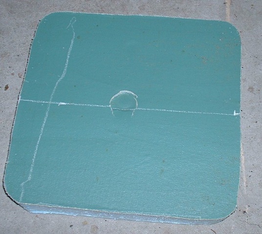

Postby GPW » Sun Jun 12, 2011 7:33 am
OK, Now Here's a TEST !!! Image
I took my best Carnival , ring the bell swing ... Frankly I expected MORE damage ... This Foam /canvas is AMAZINGLY Strong !!!! Even surprised me !!! :o :shock:
The more I do this destructive "testing" , the more comfortable I become with the idea of Foam as a trailer building material ... :thumbsup: :thumbsup: :thumbsup:
note: This was in the area that already had the original hammer blow... unintentional , just the way it landed...

Postby Conedodger » Sun Jun 12, 2011 10:13 am
GPW wrote:OK, Now Here's a TEST !!! Image
Now from that test I am far less sure.
In your test I think you may be missing that point that most of the blow has been taken up by compressing the foam onto the floor and i expect that doing the same on plain foam would have been similar.
In fact what you have tested is how its used in housing where it trapped between two parts of the floor.
However having something solid directly the other side of the foam wall or roof in a camper is just never going to happen.
From what i can see the canvas held very little and the foam acted like a crumple zone and simply disipated the blow through to the floor but it was the floor that stopped and absorbed the hit and the foam simply acted like a buffer.
Pods8 test with epoxy was done the same but just did not make a hole.
I think if you put your piece across two bricks so there is a void below the area where you are hitting the results will be rather different.
