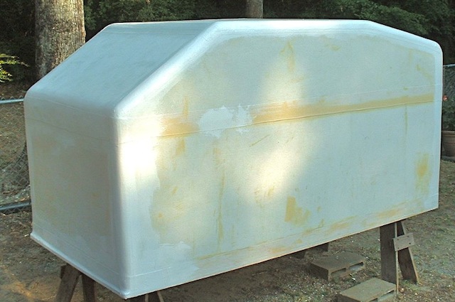

Cone' , I'm most concerned by your considerations , and must agree, that area has the highest stress in "normal" use... And with the increasing sizes , some additional reinforcing would be mandatory , which is why I'm on about the plywood/paneling inner wall which can be mechanically attached to the floor , then the foam fixed to that... That and the otherwise suggested "reinforcements " should provide ample integrity... One might even slot the floor for the ply wall epoxy that in then add the millwork (screwed and glued) then the foam ... It may even be possible to build a standard floor to wall connection , then just add the foam outside ...
Fiberglassing the entire area in question would lessen any doubt ... Messy , but less an area than glassing the whole thing .... and I still believe for the absolute Best attachment of anything to foam , the perforations will be the key ... JMHO
My little build is so small light , there's not really anything there so I can get away with "less" ..The slanted roof provides extra support , much as a curved roof would ... Don't plan on hauling much gear in it ... Just a little "sleeper".. as per the original plan ... The foam is gorilla glued to the floor , then the cloth plus doubler ... seems quite strong , the linen canvas was fairly hefty and incredibly stronger than the cotton ... Image
.,, and being an old Geezer, I drive slow anyway ... so no worries about wind shear ... not at 45mph.. :o :lol:
