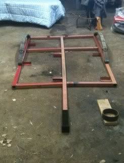

Postby DJT » Sat May 28, 2011 8:55 am
Progress pics from 05/27/11!
Laying out the frame:
Looks like everything is going to fit! But it seems a whole lot smaller in real life! :o
90% tacked up:
Got it square on the first try! :shock: Now just have to keep it true while finish welding...
You can see the industrial powdercoating in these pictures...The steel is from overseas shipping frameworks for industrial heavy machines, and the coating is designed to withstand multiple open air ocean crossings so is VERY heavy and has to be ground off before any welding or fitting...But it was free! :thumbsup:
