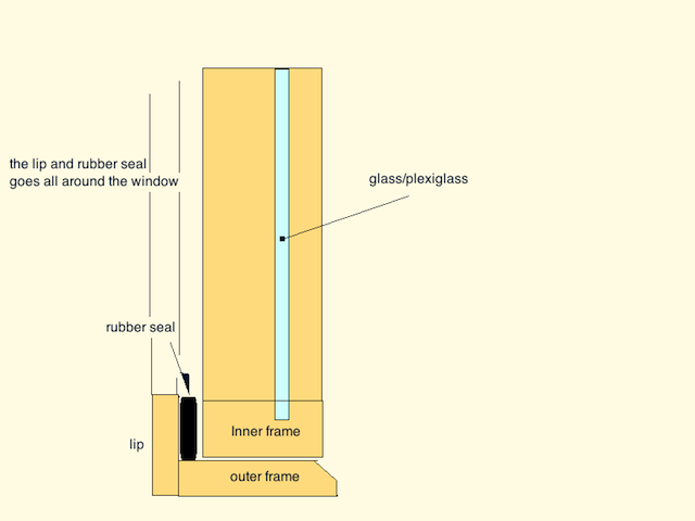

Postby GPW » Sun May 29, 2011 5:01 pm
Dj, possibly ... then there's the thought of a "lip" inside the frame ... Image

Postby GPW » Sun May 29, 2011 6:04 pm
I dunno' about the foam frame ... Maybe just some good rot resistant wood in this case ... You could fabric over the window outer frame blending it in with the rest of the trailer (like the door posts ) for more "encapsulation" ... Then you'd only see the window itself opening from the foam ... no outer frame as we've become accustomed to looking at ... kinda' cool really .... Simple enough ... should be much less $$$ than some of the trailer windows I've seen ... Even the cheapest of those still come with hefty shipping costs... :o

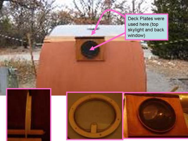

Postby Todah Tear » Mon May 30, 2011 11:48 am
What about deck plates with a clear center or less expensive opaque center that can be cut out and replaced with clear plexiglass-type material from Lowes (use pvc glue). I used them for my side, rear and skylight windows. Here is a link for some. My weren't that costly because I caught a sale (...and the link is saved on another computer), but this will give you an idea (Do a google search on deck plates to find others of a smaller size and less costly.):
http://www.gandermountain.com/modperl/p ... SHOP_82645
[img][img]http://www.tnttt.com/gallery/image.php?image_id=45238[/img]
[img]
The hatch is foam with a canvas cover. Several coats of wood glue were used to help it keep the shape, then roofing elastomer was used to complete the water-sealing of it. The windows were mounted on a plywood frame though.
Todah

Postby GPW » Mon May 30, 2011 2:20 pm
TT, Looks like the Perfect door window !!! :thumbsup:
Postby Todah Tear » Mon May 30, 2011 2:37 pm
I just took no-see-um mosquito mesh and regular window mesh and a frame to make a screen. The thing that I like about them is that they come with a seal and are designed to keep water out of places.
One warning though: When you install them, make sure that you have the insert in place when drive the mounting screws in. If you don't, you will slightly distort the shape of the frame and it won't seal correctly. I know because I did that and I ended up having to use sealant to permanently seal the skylight to keep it from leaking. I couldn't open the skylight and get a top draft from it, but it provide additional light on my galley counter while I was sitting at it on the inside of the tear.
