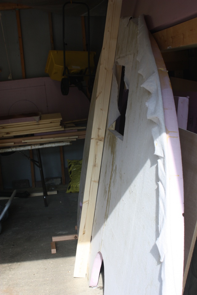

So, the door is glassed and I'll be interested to see what the panel is like once it cures.
But first, the pics:
Faired, sanded, glass on (should be green by tonight so I can trim it)
Some weapons of choice for shaping this stuff:
So now to get this sanded and primed, then finish prepping the bed for the Lexel that I'll be gluing the window in with. I coated the foam in resin thickened with cabosil. Unlike the microballons used for fairing, cabosil makes a gap filling structural adhesive. I smeared it on the foam in the rebate I made for the window and after I've cut the scrap cloth out of the opening I'll clean up the bed and get it ready to receive the window sealant.
After I pick up some more materials I can start on the floor - most likely next weekend...
I'm thinking of a frameless mount for the windows on the body, something like what one sees on fullsize vans. That way, I can simply drill three holes in the plexi and not have to incorporate a frame.
I have been looking at vans at the local wrecker's and some of them have some pretty long windows using those latches, and they're already tinted and tempered glass...and thrifty !!

Postby eaglesdare » Sun Jun 12, 2011 6:33 pm

Postby DJT » Sun Jun 12, 2011 7:37 pm
Brian, that door looks really good!

Postby GPW » Sun Jun 12, 2011 8:43 pm
W2...NICE door !!! :thumbsup: 8) Really like how you incorporated the longitudinal "spines " in the structure... That's gotta' be STRONG !!! :D
Like your collection of shaping tools too !!! :thumbsup: Cool window idea !!! 8)

I just went down to trim the edges and cut the glass out of the window opening. I had a little bit of delam on the hinge side, so I picked the door up to deal with it.
Man, is it ever light !!!!!
I'm going to be looking for some primer in the next couple days so I need to decide on what to use for a topcoat because I have to get the primer on the door to protect it from UV till I'm ready to paint it. UV is one of the few things epoxy doesn't tolerate well.
So....any thoughts on paint ?
Something that I can roll on is best, preferably something that will fill the weave in a coat or two (from where the primer leaves off).
If I lived anywhere near a WalMart, I'd try and get some of that great paint GPW used but I don't so I'll have to make do....maybe a marine enamel ?

Postby GPW » Sun Jun 12, 2011 9:39 pm
W2, a Good (Quality) Exterior Latex house paint should work fine ... it does come in High Gloss !!! Easy to work with , easy to touch up .... if needed...
If you think the door is light , wait till you get the whole trailer built ... I can still pick up either end of mine with one hand ... Towing the empty trailer today (bouncing a bit with no weight) makes me think I'll need to ballast up for the trips.... More "spiritus fermenti " !!! Guess Big Mike was right about the 500 lbs. of Beer... :lol:

Postby Conedodger » Mon Jun 13, 2011 4:32 am
Two part epoxy floor paint would work. They also use it to re-coat swimming pools, its would harden to a second solid skin

Postby Wobbly Wheels » Mon Jun 13, 2011 9:26 am
Epoxy floor paint...of course !
:duh:
I used some Interlux a few years back when I was "re-purposing" some shipping containers. It took a while to cure but it was rock hard when it was done.
Just have to price it out now....fortunately it shouldn't take much.

Pat, thanks for the kind words. I spent a lot of time as a boatbuilder and learned early on that fiberglassing is a skill you NEVER admit to knowing...otherwise you wind up doing little else. I'm out of the production environment altogether now and, now that it's a sideline for me, I enjoy doing it again. Of course, epoxy is easy to work, really forgiving, and pleasant to work with.
And now...on to the pictures !!
Here's a quick test I did this morning to show how stiff this door is. What's especially impressive is that the weight feels like around 5 lbs !!!!
Those pavers are 8X16 and 16X16 and 2" thick.
It's a bit tough to see, but the deflection under that weight is only about 1/4" in over the 4' length of the level. For comparison, 1/4" per foot (1"over the same scale) is considered the minimum for decks and roofs to get water to run off.
I'm calling the 'shear web' stiffener experiment a success. Now, on with the build !!
