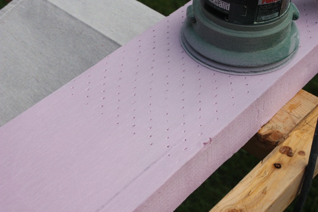

I'm also wondering if you did anything special to prep the foam before applying anything to it. When I work with closed cell foam in making door panels and such, there's a skin that has to be removed from the foam before gluing it. The glue bonds to the skin just fine - that skin will just pull away from the foam itself over time. Is there any kind of skin on the foam you're using (indicated by a shiny finish,) and if so, did you sand it off before you applied anything over it?

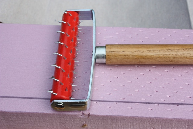

I didn't do any special preps to the foam for the test, other than use my roller that looks wicked... I'll post a picture of that later too!
But on the actual walls, I would sand em with a random orbital sander just to rough em up a bit.

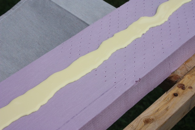

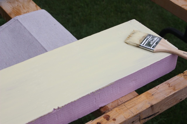

Postby mikeschn » Mon Jun 27, 2011 6:27 pm
Okay, you guys did it... You made me go out and do another sample!!! :lol:
Here's the blow by blow...
Tomorrow night I'll dilute the titebond II and put a layer on top. Then Wednesday night I'll make the video for Cone!

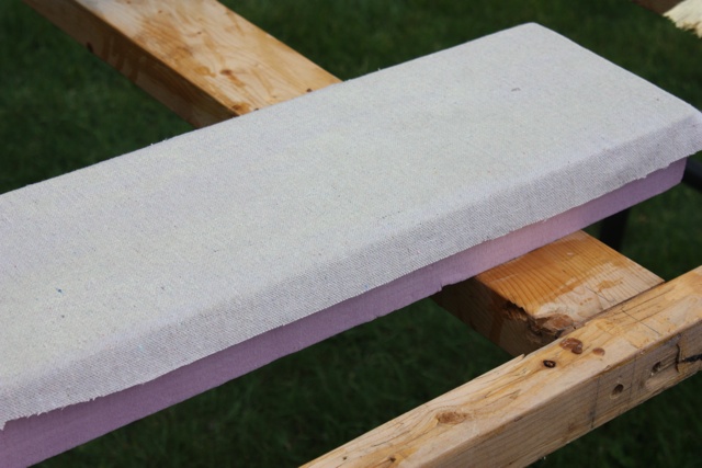

Postby Conedodger » Tue Jun 28, 2011 4:26 am
Thanks for testing again Mike.
I am sure you have read all i have written about the importance of it being wrapped.
Your Image
Shows what i mean as its not wrapped at all. The loose ends of the cloth must be stuck to something thats porous. So in our case that is wood or another layer of cloth, but not just foam. If its not porous it will simply not dry or bond, if one part is porous it will dry over a long time and bond to one side and slightly stick to the other.
You need very little stick as long as the foam cannot move. All the strength is from the porous to porous joint not to the foam
This is wrapped
I think this is one of the issues with using foam, in that people wrongly think covering foam on one plane with something makes it some sort of super strength composite but is doesn't. Its just keeps the outer skin in place and stops it moving, its the skin thats the strength. Wrapping the foam adds a lot more strenth.
