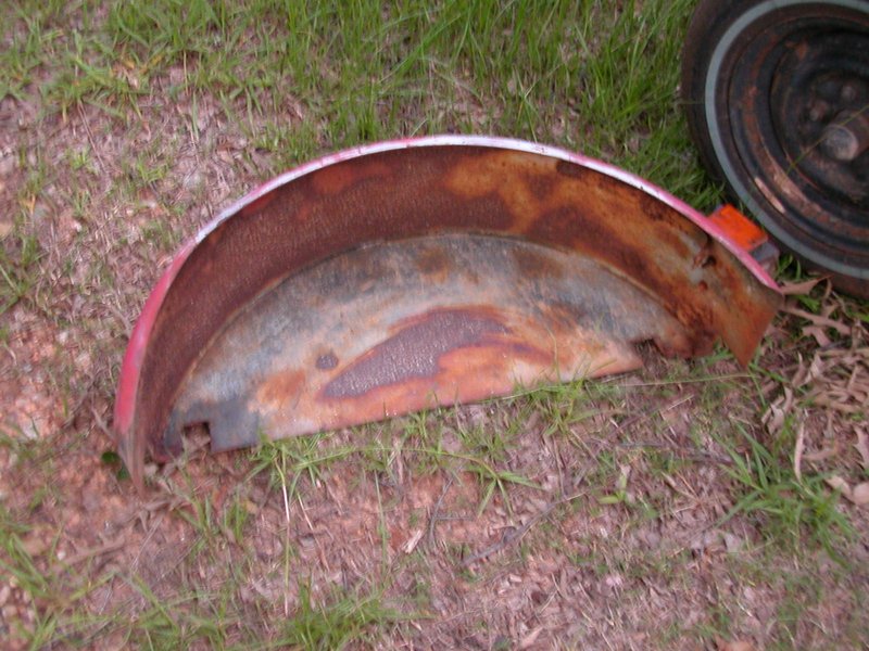

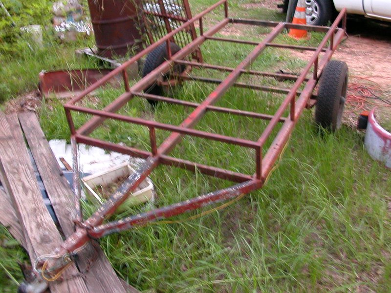

Got home and though I didn't really feel up to it, went out and did a bit of tearing down on the frame. Got the floor and tail gate off. Will work on removing the railings next. Did a bit of figuring and if I use railings they need to be in the 16 to 18 inch range. These are 8" so need to be removed and used as parts.
Sorry for the blurry pictures, took them just before dark and the camera doesn't like that time of day.
Stripped of floor and tailgate. Side rails are next to go.
Fenders should be usable with a little work.

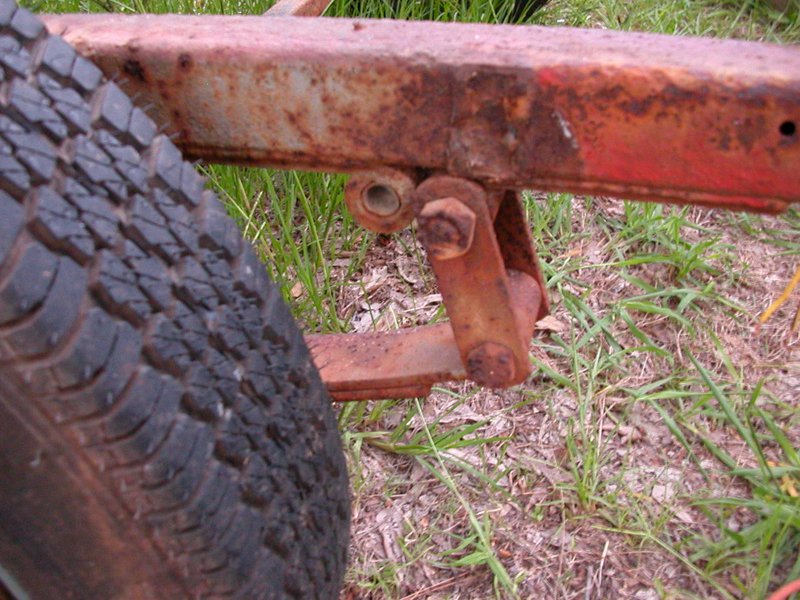

Looks like the springs have been replaced before. Gonna have to take them off/apart and see what all will need to be redone/replaced.

Looks like you are making progress. I was looking at the pic of the trailer frame. With the integrated side rails it looks very strong as it is. Why not just stack the needed additional rail height on top of the existing structure. That way you don't violate the integrity of what you already have. Probably less work to just extend the rails as well.

After going out and looking at it again this morning I'm gonna have to agree with you. I was wanting to get 48" X 96" clear floor area which with the rails in place the way they are I don't have. The area is 46" X 95", but I can notch the plywood for the floor out and make it work without a lot of trouble.
Also am now thinking about building storage boxes under the side seating/work areas outside of and above the existing rails to bring the body width out to the 76"/78" point. Not sure if these will be inside access, outside access, or a combination of both.
With an upper inside width of 6' to 6'2" I can turn the bed sideways and have a much wider table/seating area (along the lines of the one designed by Tinksdad) and only take up about half of the trailer length.
Hoping to get some time this weekend to get the axle and springs off, frame cleaned up and at least primer put on. Will see what things look like then. After all it is a work in progress and apt to change drastically... :? 8) :lol:
