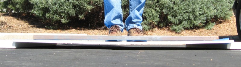

Postby Trackstriper » Mon Dec 26, 2011 3:19 pm
Aluma-Corr stiffness/strength.

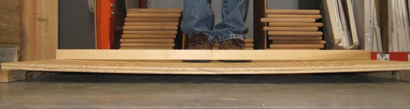

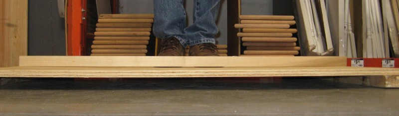

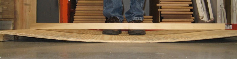

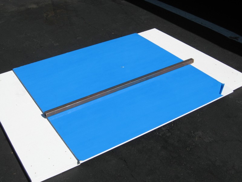

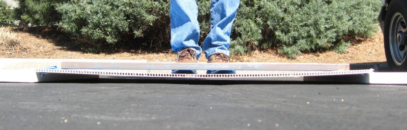

OK...this is just for what it's worth. I ran some tests about three years ago to check out the panel stiffness of 10mm Aluma-Corr vs. plywood. Yes, the guys at Home Depot might have thought I was a little off....but they didn't bother me. The Aluma-Corr was tested at home, using a piece of 1x1 steel tubing as the straightedge. The A-Corr was 48"x48". The panel was supported with painted 2x whatevers that I had handy.
At Depot, I used 2x4's to support the plywood and a straight piece of 1x2 maple for the straightedge. All plywood was your garden variety, perhaps B-C grade....what they had in the pre-cut 48"x48" rack.
Fun and games blocking up and aiming the camera, setting the timer and getting myself into position. Test dummy weighed 165# wet. I stood in the center of the panel with my toes against the straightedge.
This photo is typical of the test rig, the white Aluma-Corr had a protective blue film on the surface. The 2x supports just happened to also be painted white...hard to see edges:
Next is 10mm A-Corr in the strong direction, working with the corrugations...think corrugated cardboard:
This is the A-Corr in the weak direction:
Next, 3/4" 6-ply plywood, strong direction:
Same 3/4" ply, weak direction:
1/2" 4-ply plywood, strong direction:
1/2" plywood, weak direction, in which case I'm supported by the concrete floor:
The Aluma-Corr was a little less stiff than the 3/4" plywood and more so than the 1/2". A good, equal comparison would be quality 1/2" cabinet grade plywood with many plys. Remember, this product weighs about the same as true 1/4" plywood, is pre-finished, won't rust, won't rot. No, I don't sell this stuff.
Hope this helps a little.

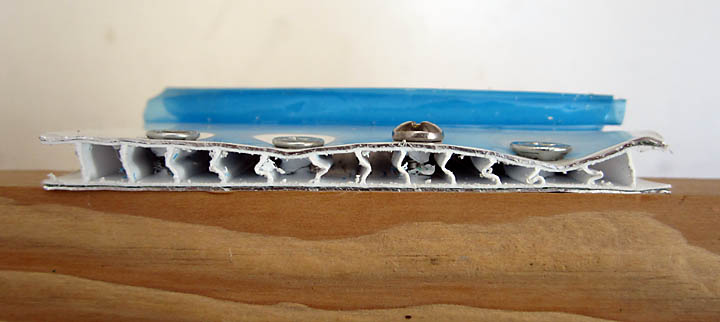

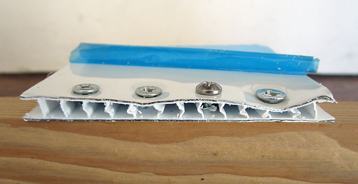

Screwing through AlumaCorr
Postby jonw » Wed Dec 28, 2011 2:07 pm
Here are pictures of a test using screws of different sizes and types, screwing a sample of AlumaCorr to a piece of pine.
All screws were drilled using a Harbor Freight 18v drill that has a maximum clutch setting of 17.
From right to left:
1) a Spax 3/4in #8 self threading wood screw drilled through the AlumaCorr without any pilot hole, and with the drill clutch set to #5. Notice the crushed surface.
2) a round head 3/4in #6 screw, with a pilot hole drilled first, and the drill clutch set to #5 (same as above). Note it does not compress the AlumaCorr at all. I suspect much of this is the difference in force between the #6 and #8 screws...
3) a Spax 3/4in #6 self threading wood screw, no pre-drilled pilot hole, and with the drill clutch set to #3. Better than 1) but still some surface deforming and internal rib crushing.
4) same Spax screw as 3) but with a pilot hole drilled only on the top surface whose diameter is about halfway between the thickness of the screw shank and the screw head. This was a rough attempt at countersinking. IIRC the drill clutch was also at #3. Note minimal deformation.
It still needs some experimentation, but in trying to get screws as flush as possible without compromising holding power I think 4) with a slightly larger hole with the same or lighter clutch setting would yield the best compromise.
It also means that if we use AlumaCorr with screws we need to do some test drilling with the screws and the wood we'll be using to determine the correct countersunk hole size and drill clutch setting.
As with everything else, YMMV.
