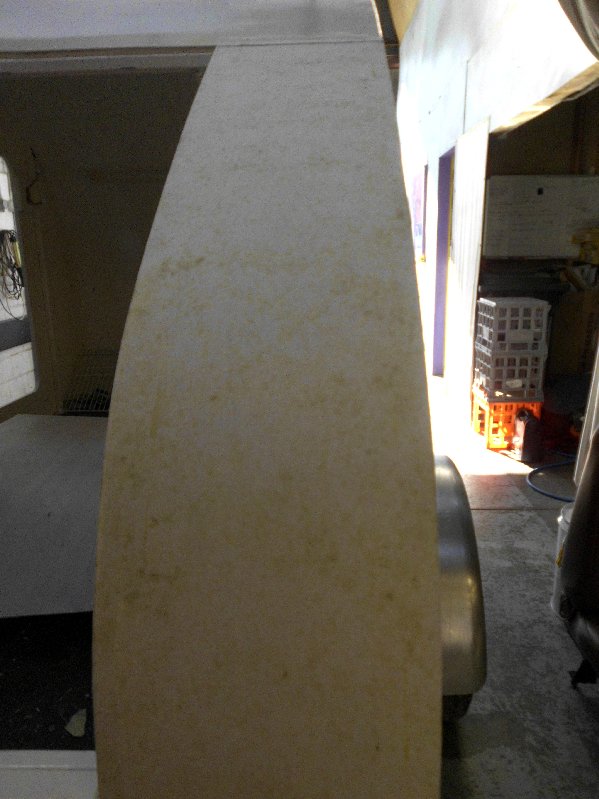

Lancie49
Posts: 86
Joined: Sat Mar 03, 2012 8:53 am
Location: Melbourne, Australia
Re: Avoiding the Shrinking feeling
Postby GPW » Thu May 03, 2012 7:59 am
Beauty job Lance !!! 8)
