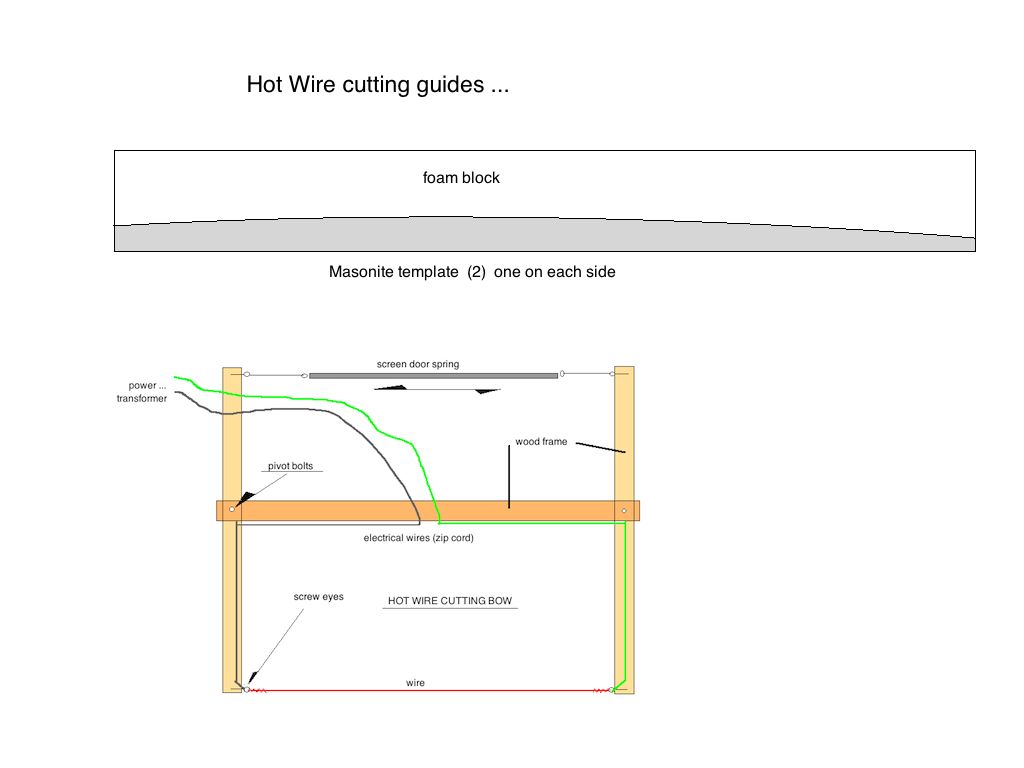

I made another drawing of the Masonite templates to cut the curve (rocker) into the foam ... seems easy with a hot wire ..
BTW , I notice a lot of these are made of EPS beadboard blocks with epoxy as an adhesive , or Urethane foam with a polyester resin (which won’t melt that foam ) ... Nice that beadboard works since I can get so much of it (cheap) ... Should work Fine on a Trailer too , same density as the Blu/ Pink stuff ... very little difference except in the sanding ... beadboard being a little more sensitive to tearing out the beads ... hand sanding all in one direction is advised ...
