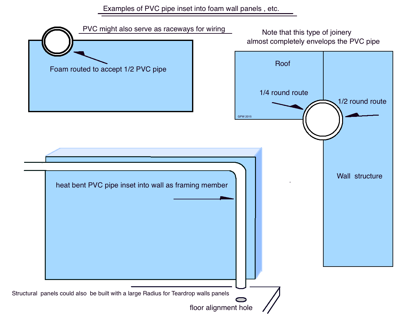

... and back in the workshop ... I couldn’t help but to make another drawing depicting an idea of how PVC pipe could be used in place of wood for Foamie’ camper framing . That alone would make the cabin part entirely rot /waterproof , and yet allow for wiring runs and light duty attachment points . And as you can see with the drawing on the right how it could be almost “enclosed" in the wall . And inset into a floor for perfect alignment and joining. :thinking:
It would be easy to bend big graceful curves in PVC and inset that into Foam Teardrop sides for that distinctive shape and look with no hassle ... just a simple glue up.
Now all we need to do is come up with a really simple PVC Trailer Door frame and foam door ... ;) :thinking:

That square PVC tubing you can buy on Amazon would work very nicely as a door outer frame and even ships in 2"x2"x48". George's flashing technique would work fine for the doorway edge. If you can find a reliably strong glue for PVC to foam. Wonder if you can heat PVC pipe enough to melt stryrofoam - get it to sink in and form it's own raceway & glue ?
