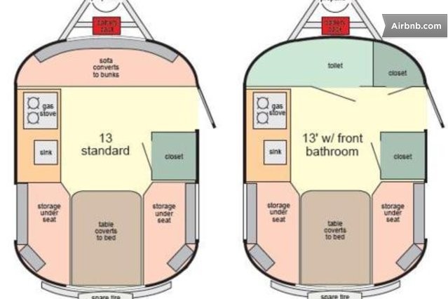

If you want to go 3 feet longer you could go with the Burro design. It has a dinette that folds to a double and a sofa that converts to bunks (like described earlier). Also you get a small inside kitchen and closet inside.
