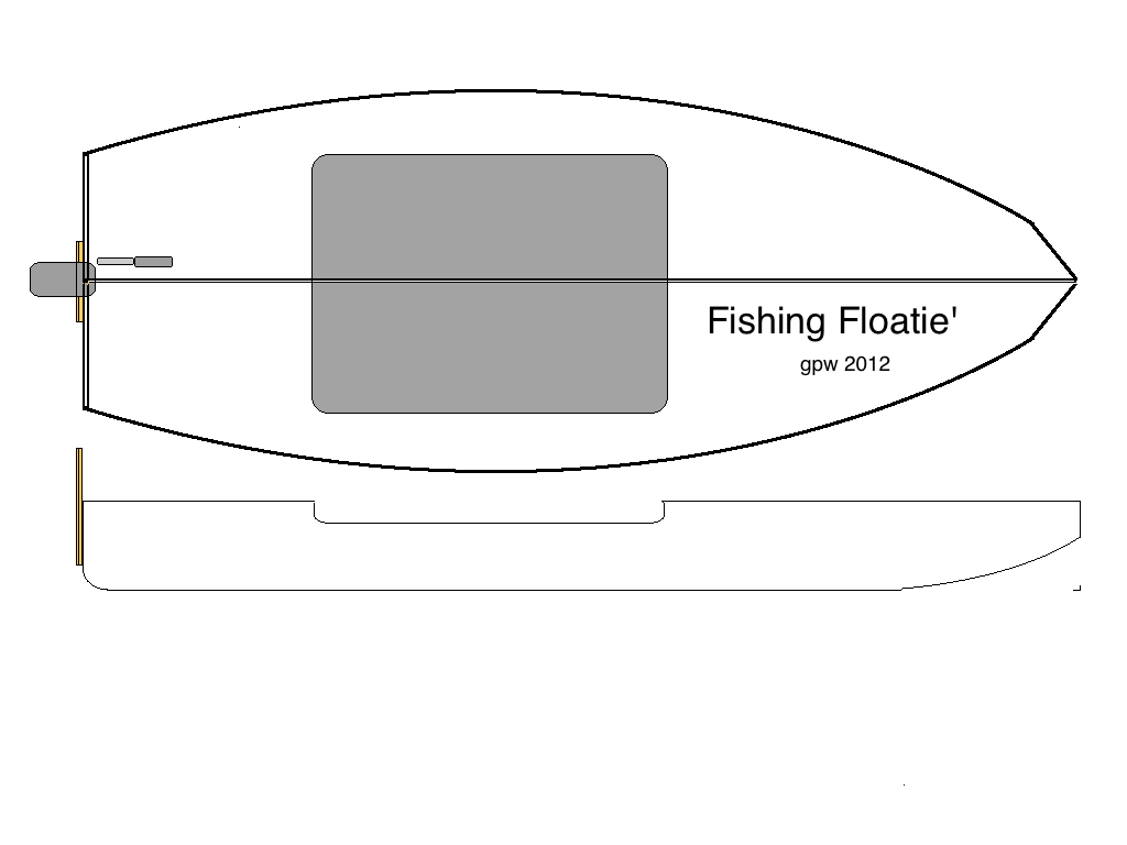

We, however wanted something more sedate ... just something for those shallow quiet fishing areas (the points) ... Sorta’ like this : Simple ... Unsinkable ... wide enough to stand up in and cast ... ~ 40” W ... just big enough to fit in the back of the pickup ... :thumbsup: Foam , 1/4” ply spine , covered in a light canvas per the usual ... painted “Duck blind green” ... the fish can see too ... :D
Foamie Fishing Floatie'.png (16.38 KiB) Viewed 710 times

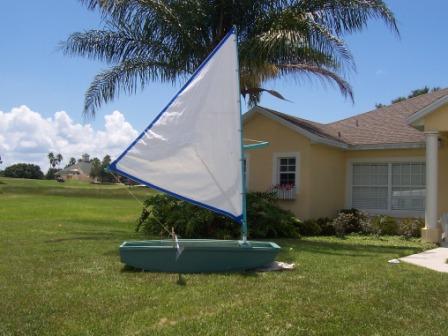

Painted rigged ready to sail or paddle

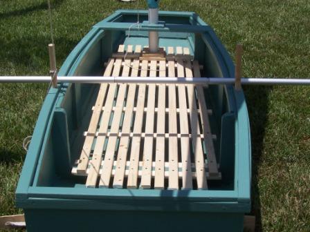

Applied mast thwart and mast step. Built a seating platform because I know the foam will not support my weight. ;) Painted with porch emamel.
Seat platform with mast step attached
Ready to sail or paddle.
Sail up
Going to try to sail this using a paddle as an oar and without leeboard. Will attempt to use the boat chine (side) to act as a leeboard. Have Plan "B" if a leeboard is necessary.

That looks TERRIFIC!!! :thumbsup: 8) 8) 8) You may need the board on a tack ... :NC

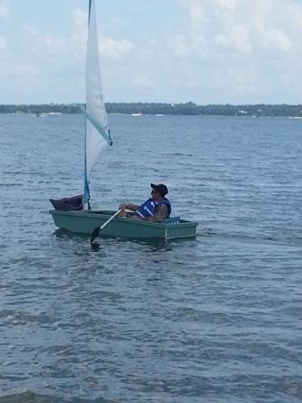

Pic of me just beginning to sail the Yak. Sorry for the quality, friend took the pic with his cell phone. Have some video that I may try to upload at a later time. These little boats make a nice addition to our TDs. Can sail, paddle or row easily.

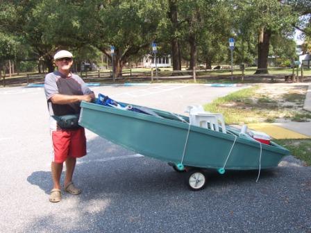

Getting ready for paddle on Silver River
Sailing
Sailing the Foamey Rat 2.jpg (27.16 KiB) Viewed 560 times

What sail rig are you using?
Is tthat from another boat or homemade?
I have a 10' skiff that I'd love to put a small sail on.
Warren
'Action' shots are great by the way :thumbsup: :applause:

Postby clermont cubby » Sun Aug 11, 2013 9:01 am
Warren:
Its a homemade LOM sail (Leg Of Mutton). Go the pdracer.com web site and search for homemade sails. The example they show is for a 59 sq ft area LOM sail. The mast is approx. 16' tall. I only wanted a 35 sq ft sail - 12' tall mast so I resized the original dim. I used a heavy white polytarp, carpet tape to secure the edges and my wife sewed the edges for additional strength.

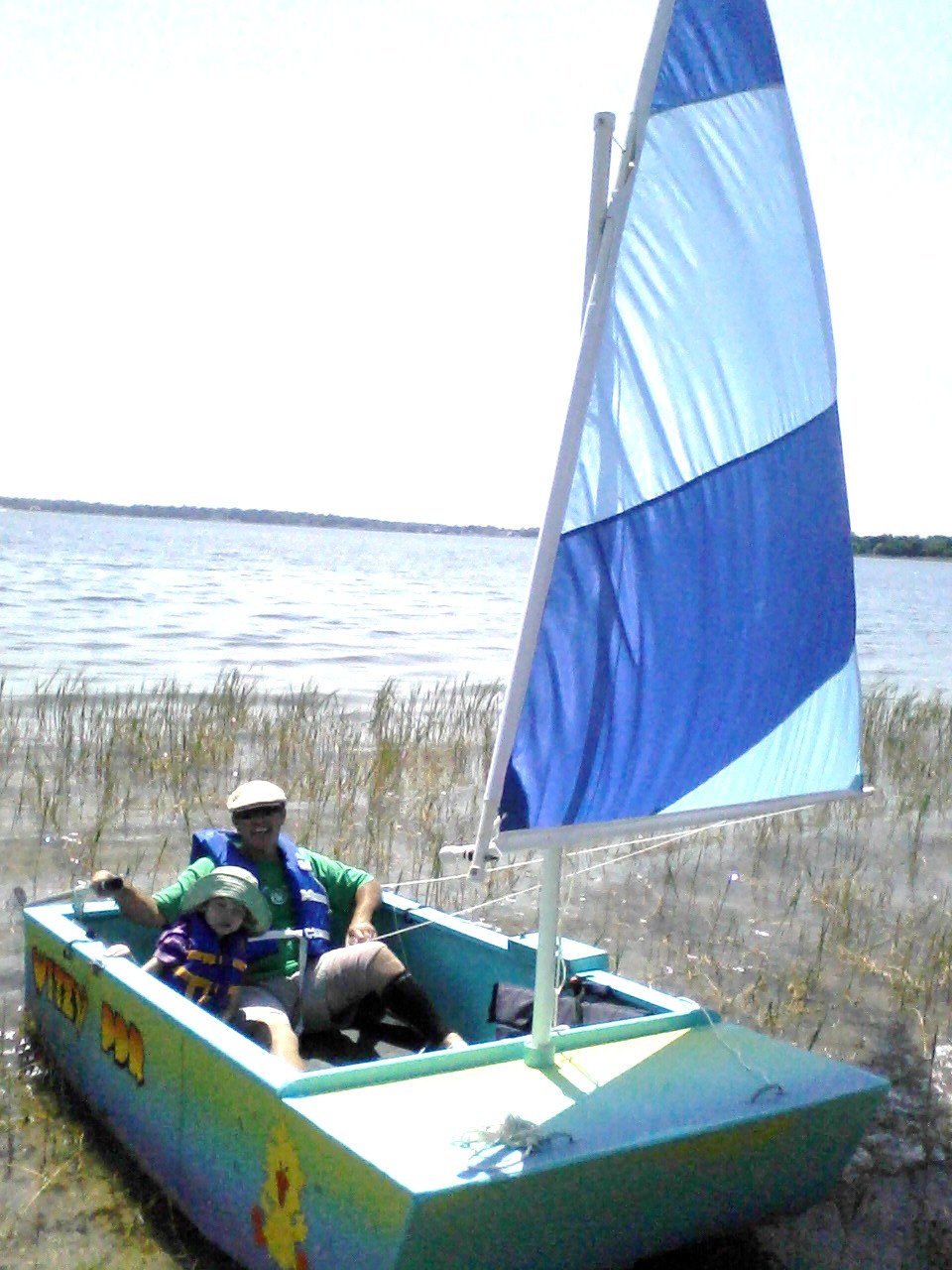

I also have a 45 sq ft ready made nylon sail from sailboats to go.com . Made the mast and spars from PVC pipe strengthend with metal conduit inside. That may fit your needs better.
Larry
45 sq ft sail
