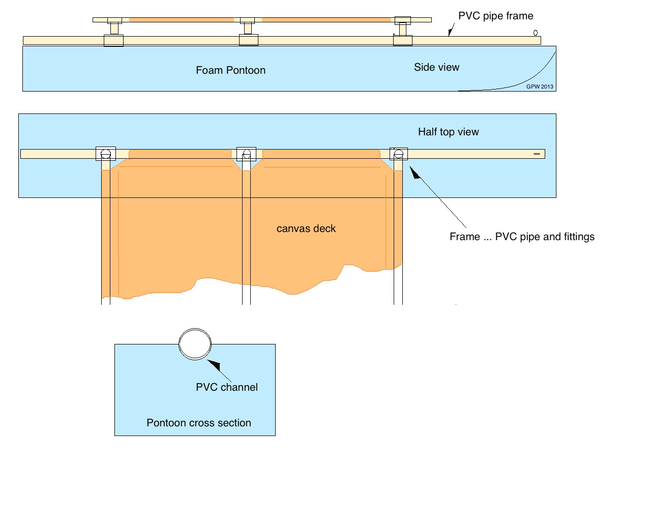

just an idea ...The PVC pipe becomes the frame and the reinforcement ... :thinking: No need to even cover the foam ...

Mary , we saw some spray foam things that looked like traffic cones being made ... sprayed in molds, and a pipe inserted before drying ... Maybe make a simple pontoon mold , insert a reinforcing frame (like PVC pipe) and spray the foam in ... instant pontoon , with attachments ... :thinking:
