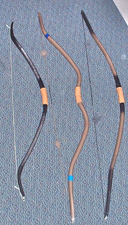

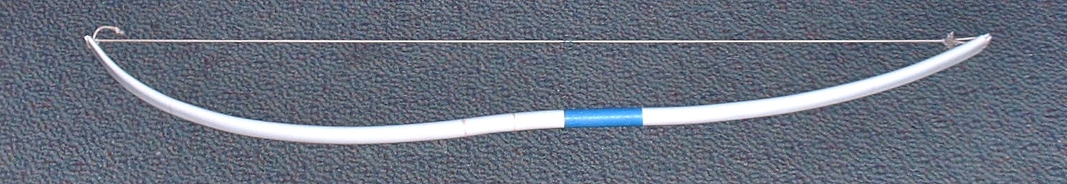

Just to add a little interest to the conversation , here’s some pics of PVC bows we made ... and they really Shoot too ... Not a Toy !!! Made by heating PVC plumbing pipe and bending and flattening ... I learned it all from the Backyard Bowyer on You Tube ... plenty of possibilities for trailers ... very Thrifty too . a 10’ length of 3/4” PVC is ~ 2 bucks ... :o
