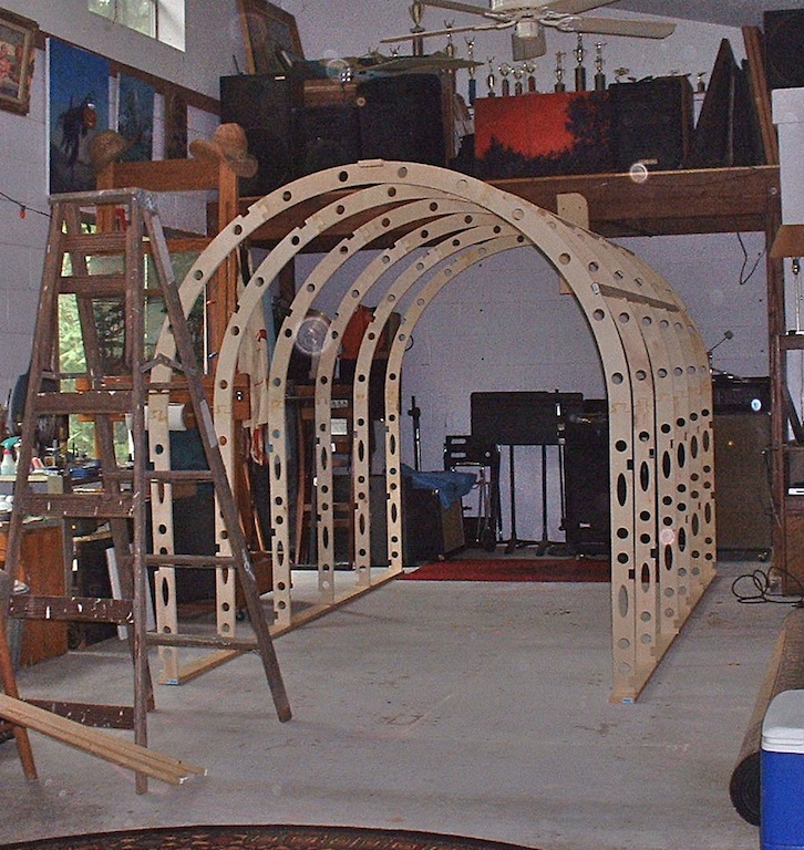

"or I have to build the frame first, store it somewhere, build the box on the floor, drag it outside, then put the frame under it. “  ...That’s Exactly how I built the Foamie #1 ;) Built the cabin , even painted it on two saw horses ... then built the trailer , had some friends lift it on the trailer (Light) , bolted it down and that was that !!! :thumbsup:
The FoamStream frame was built in my Studio , and it just made out the 6’8” garage door ...
