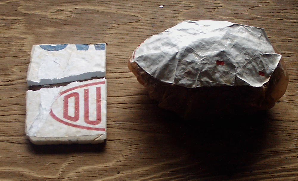

Thanks Randy, glad you're enjoying my little science project. I did 2 more tests to my tyvek/casein composite. I tried to break it. The tyvek and foam snapped with medium hand force. I could not fail the FG and casein by hand. It's pretty strong-I'd have to put it in a vice and fail it with a hammer or maybe stomp up and down on it. It's much stronger than the Tyvek composite. The other experiment that I did was to try to form the tyvek around a compound curve. I wrapped a football (American) in a trash bag and glassed it with tyvek/casein. It was a mess since the Tyvek has no drape. So I had to wrinkle and force the tyvek around the shape. I suspected that it was going to be difficult since the tyvek feels pretty stiff in my hand. The addition of the glue didn't soften it at all.
So the conclusion I arrived at was that the Tyvek would be good for flat surfaces and light builds, like maybe a bike trailer. It could also be very useful as a layer over a coarse weave fabric. The Tyvek finishes out very smoothly and would act as a structural filler.
