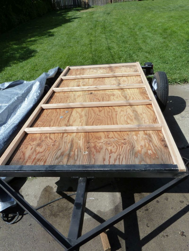

After rearranging the garage a bit, cut and assembled the subfloor frame. Looks about right considering my pitiful woodworking skills and recycled slightly warped 2x4 lumber from the dumpsters. :lol:

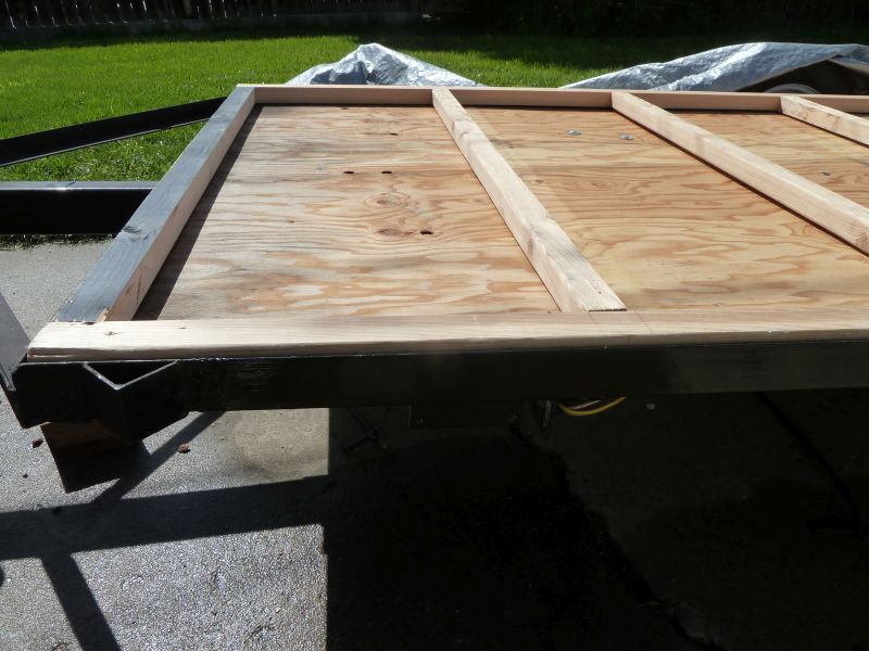

Good enough for me - fits inside the angle iron which is a real accomplishment. You can see from the side view that the top of the 2x2s clears the angle iron so that the 1/2 inch OSB floor can hang 2 inches wider the trailer frame on each side. The OSB gets cut and attached to the frame tomorrow and then a couple of coats of the waterproofing mix. I will sand where the walls will be attached before they get mounted but I might do a bit of work on the walls before they go vertical like running the wiring raceways & perhaps canvassing the interior.
I reread George's #1 foamy thread in preparation; lots of good schooling in there for me.
Frame top clears angle iron.jpg (105.65 KiB) Viewed 1574 times

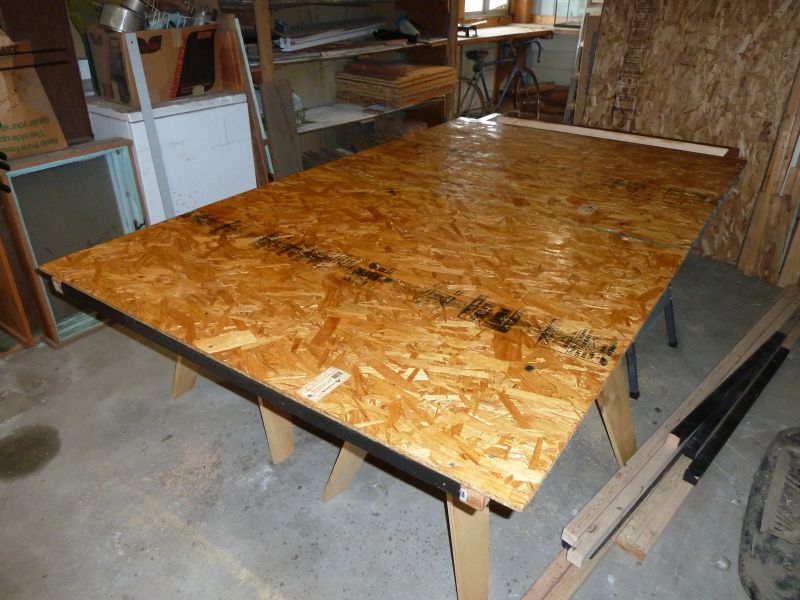

Picture is worth a thousand words - speaking of which, my floor (the 2+inch overhang shows good) with a couple of coats of "the mix" applied:
OSB floor with 'the mix'.jpg (117.56 KiB) Viewed 1412 times
Fred Trout
Posts: 396
Joined: Fri May 08, 2015 4:30 pm
Location: SW Montana
Re: Bread-loaf build thread
Postby GPW » Sat May 16, 2015 11:12 am
Very NICE !!! :thumbsup: 8) The mix does make a difference... :thumbsup:
Postby Fred Trout » Sat May 16, 2015 11:39 am
OSB really soaks "the mix" up with some wood chips going shiny and others yelling at you "moar !!". I think I will add a couple coats of pure urethane on top since those chips pop-off when you look at them sideways. I learned the hard way not to bother removing the stickers you see on there - the wood chips come up with em :shock:

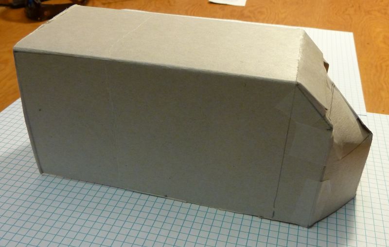

Will stick in my cardboard model in here - should look something like this or an order of magnitude close to this or with a wing and a prayer on a good day ...
