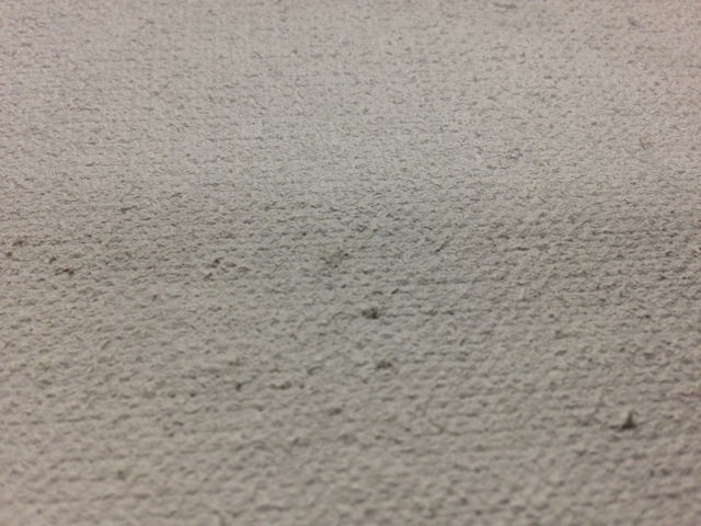

okay, both samples have dried overnight. I tried pulling up a corner on each sample. It does come up, but not nearly as easy as TBII. So Jack is right. It really does have good adhesion to EPS. And it appears that the first coat completely sealed up the canvas. I guess that is something to think about as I figure out how to proceed.
It's time to think about the 2nd coat. What would be best?
More Glidden Gripper Primer?
TBII thinned out?
1 part epoxy paint? Like garage floor paint...
Spot Putty?
Closeup of the canvas:

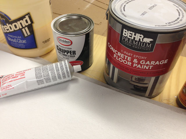

Postby mikeschn » Thu Jul 09, 2015 3:46 pm
I'll be ordering some of those for sure.
Meanwhile, I went and painted 1/3 of my canvas sample with the garage floor paint, and another 1/3 with TBII, thinned out a bit. My first impression. The garage floor paint went on nice. It acted like it penetrated and melded with the Gripper.
The TBII didn't do as well. It felt like a layer of water on top of a sealed surface, and they just weren't getting along.
Naturally it's too early to tell, and I still have to do another 1/3 with the Gripper, but I'll check in later.
