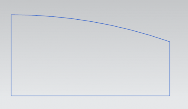

Postby mikeschn » Sun Jul 12, 2015 5:57 pm
If I wanted a slightly curved roof, how much could I curve the foam without having to kerf it?
I'm looking to improve the water run off, and make it look cosmetically a little more appealing. any ideas?
Here's where we are at with the flat roof...
Re: Latest on foamies
Postby mikeschn » Sun Jul 12, 2015 6:21 pm
Just for fun, I took a full sheet of 2" foam and clamped it to the table. I left 6 feet overhanging. Then I measured it completely horizontal. It was 32" from the ground. Then Chell put a little bit of pressure on it with one finger and was able to bring it down to 16", no problem. So we can drop it 16" over 6'. What would that look like?
Okay, I had to try it. Here's 16" over 8' (certainly doable, since the test was at 6')

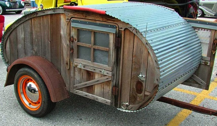

Postby djdawg » Sun Jul 12, 2015 6:36 pm
Wow, Mike and everyone! Thanks so much for everything! This is awesome...
I did read the thrifty foamie thread but I think it would do me well to read it again...and again...and anything else I can read. Responding here is so nice of you all and really helpful! I can't begin to express to you my gratitude. :)
Mike, it looks like you're thinking I would be using the very popular HF 4'x8' foldable trailer and you would be correct. Score! 2 points for you! Unless I can score something cheaper that's what I'll do.
A couple of thoughts...I'm really interested in putting a queen size mattress in the thing (cuz I'm a big guy and who knows, maybe I'll have a bunkmate now and then, ha ha) and I've seen in other threads that it can be built wider over the fenders. (or are they left off all together?) I need to read more about that. And when the heck do you put the mattress in? Obviously it's before you get all four walls put up...or else I'd be cutting it in pieces, :lol:
Also thinking that I might purchase a decent door already made? It doesn't look TOO difficult making one out of foam tho...I'm up for that too. Windows I might purchase as they don't sound too expensive. I'd probably put a shelf inside somewhere. A light on the outside would be nice and one on the inside. Although I could do a battery operated one on the inside too.
I saw in another thread (I think a non foamie thread) how someone put a outlet receptacle (not sure if that's the correct wording) on the outside and some simple wiring consisting of extension cords inside for various things. Of course this is under the assumption that I'll be in a campground that will have power available. I did build my own really cool hot dog cart so that's given me some confidence in attempting this.
Speaking of hot dog cart, one material that I used on it a lot was corrugated metal. It can look awesome (in my opinion), is lightweight so I think pretty perfect for a foamie project, is about $13 for a 4'x8' sheet and is durable and easy to work with if you have the right tools. I found a pic of a really rustic one (too rustic for my liking) that used corrugated steel for the roof! No kerfing! It looks like it's part of a wooden TD though so I'd have to put some thought into how I'd attach it to a foamie. My initial interest in it though was using it on the sides for cosmetic purposes. I didn't want to cover the whole thing with it but accents here and there like on the bottom half or something. To attach it to the sides I think slipping in 2" wide wood slats into the foam sides might suffice? Of course I would still do the canvasing/TBII on the sides to insure waterproofing.
The biggest question mark I still have is what people do with the inside? I don't recall seeing a lot of projects canvassed but I could be wrong. I think another material (my favorite corrugated steel, hee hee) would look awesome inside. A person could even do the corrugated plastic inside which would be lighter weight and also offer different colors.
Anyway, thank you again everyone!!!!
log-cabin teardrop-trailer.jpg (95.89 KiB) Viewed 1831 times
Kevin
