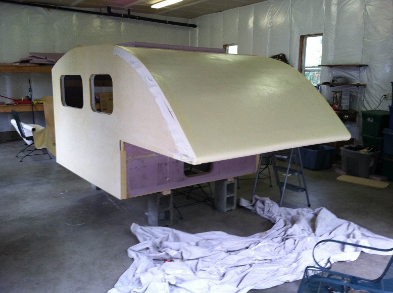

Thanks for all the kind words! I had the opportunity to use this amazing workspace for FREE and I couldn't pass it up. It has huuuuuge, and came with some tools. The downside is It's 800 miles from home! So I'm alone most of the time and I've done 100.00% of the work myself. I'm going a wee bit insane here so all of your comments are reassuring me I'm on the right track :lol:
I've got the second wall and the door canvassed, now I'm hoping to do a final fit of the door and start wrapping the top and back. The door frame flexed/warped a TON when I glued the roof down so I've got my fingers crossed I can straighten it out again.
Question: What glue would be best to attached 2" aluminum angle to canvased foam? Screws/bolts would be best but there's no wood behind the foam....
I'm thinking about leaving some extra space in the doorway then "framing" the sides in AL angle after i canvas because I KNOW I'm going to be kicking/bumping/scraping those edges. As it stands they're just foam, no wood.

Postby ghcoe » Sun Sep 20, 2015 12:33 pm
You might try some drywall beading for a hard edge. More frugal than aluminum and thin enough so you do not need to leave a large gap. That is what it is for, to protect dry wall edges from scrapes and bangs.
If it were me I would try caulking for a glue in that situation. I have used caulking for quite a bit of gluing lately on my foamie and I like it. If bonds pretty good and does not foam up which could cause lifting.
George.

Postby seanc » Mon Sep 21, 2015 2:03 am
ghcoe - Drywall bead is handy stuff. I've got the metal/taped stuff on all the straight exterior corners. I chose not to use the curved vinyl bead for the roof line. We'll see how soon I regret that.... I would use it on the door frame but I've already kicked it (and taken out a chunk of foam) twice, and I'm anticipating it's going to be a spot of constant abuse. I like the caulking idea.
I started wrapping the roof. It took me three hours to measure, cut, adjust, readjust, readjust again, glue, etc.. and finish the first piece of canvas. It was a SERIOUS wrestling match to get it taught. :?
I wrapped the door last night and it took FOREVER to dry... Luckily I have a cabover oven! I buried the door and a small heater behind some leftover foam. Dried a whole lot faster!
A couple hours oven time and another round of canvas wrestling and I'm left with 90% of a roof and a mostly dry door. Tomorrow I'll trim the edges of the roof flush to the walls and tie the roof/rear wall/base together with one last piece of canvas.
