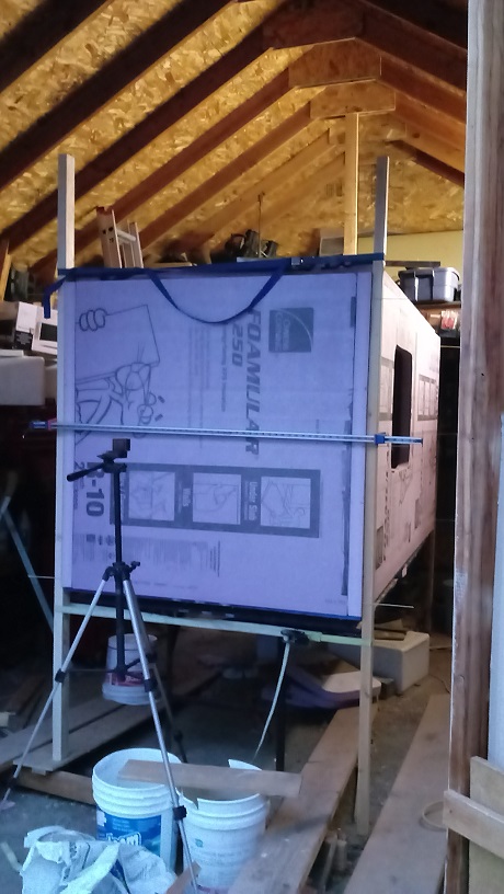

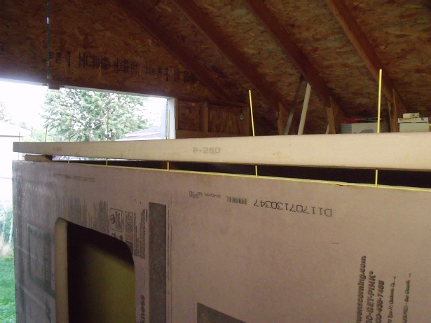

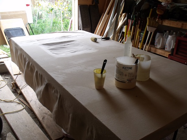

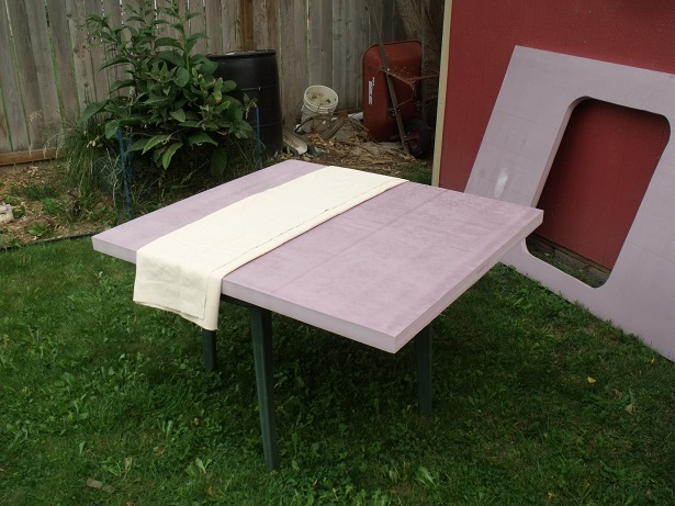

A bit of info on #2.
In a attempt to cut down hours and hassle I decided to apply the interior canvas first before gluing up the walls.
Interior walls canvased
End wall interior wall canvased
The roof being readied for gluing.
Skewers
George.
ghcoe
Posts: 1982
Location: SW Idaho

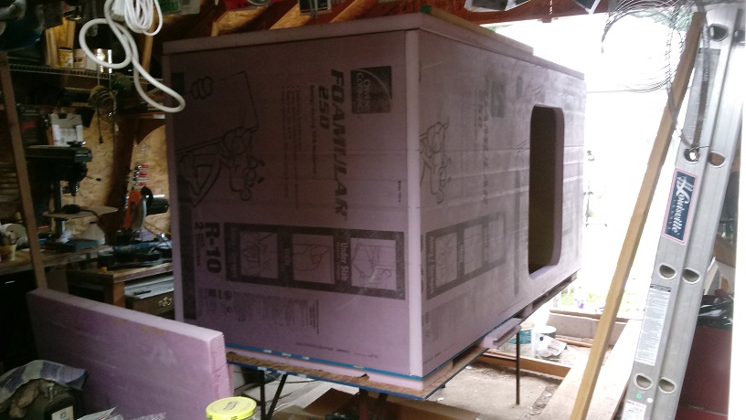

Postby ghcoe » Tue Sep 12, 2017 7:43 pm
I am 18 hours in on this build and it is ready for exterior canvas. :thumbsup:
Ready for canvas
Wall glue up
George.
