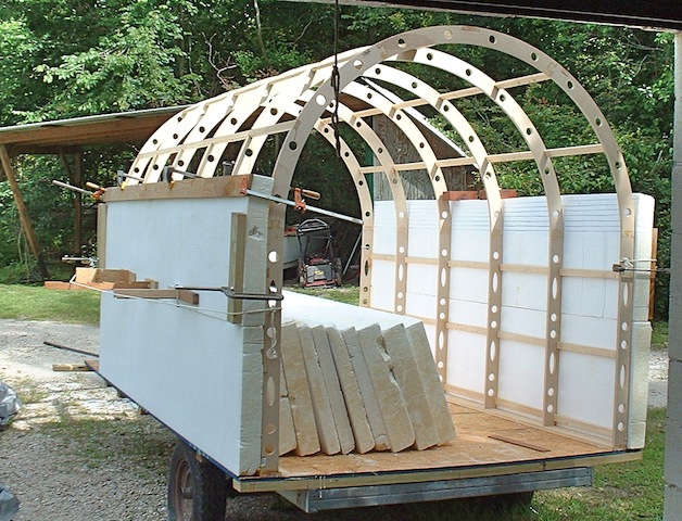

Postby GPW » Mon Jan 11, 2016 8:36 am
Don , from our humble experience , Canvas over foam adhered with TB2 seems to work the Best ... And it’s best to allow for a little shrinkage as the canvas dries too ... once all good and dry then the Gripper or some other good WB (water based) primer , before painting with Exterior latex paint ... That makes a strong durable finish that allows easy maintenance and repairs if necessary as the combination tends to heal itself of small dents and bumps .... Well tested ... PMF ...
On the inside of the trailer , you can use anything you like , paneling , chipboard , Kraft paper , bedsheets , or canvas ... What You want ... ;)

Postby GPW » Wed Jan 13, 2016 8:10 am
Don , perhaps an inner framework like on the Foam Stream ..... The attaching the foam is easy ... :thinking:
