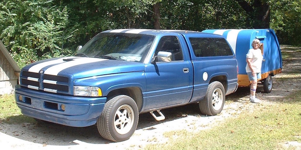

Don , I was fortunate to see Mary’s camper in person and I can tell you , it’s really Cool !!! She did a GREAT job !!! :thumbsup: 8) :applause:
Re: Attaching a foam wall to floor
Postby Mary C » Thu Jan 21, 2016 1:56 am
Awww Thanks GPW Wonder if you could put that picture you took on my Grits thread, you would make my day if you could.
now, I had no trouble in glueing on the canvas except for the 80 to 90 degrees sun. the glue dried up before I could get the canvas down. I didn't have the shrinkage problems everyone else had except one little place that GPW pointed out to me. but wait that was a year after must have been a stress crack. I put on the glue with a roller and used a plastic scraper to push down the canvas. This is similar to putting on wall paper. no problems. It is a lot easier than you think.
Mary C.
Mary C
Posts: 1776
Images: 473
Location: Waco, Georgia
Postby GPW » Thu Jan 21, 2016 5:42 am
Mary’s camper ... :pictures:

Nice looking trailer Mary!
