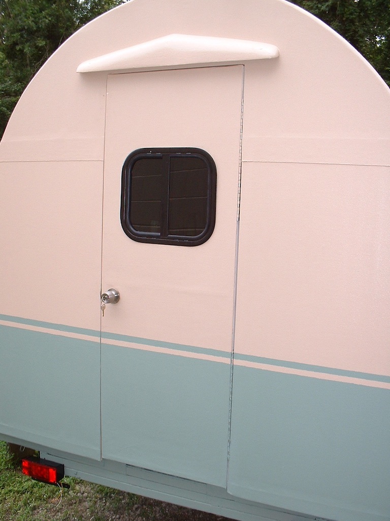

Postby GPW » Tue Mar 15, 2016 6:12 am
79597
79627
79300
What we used on the Foamie #1

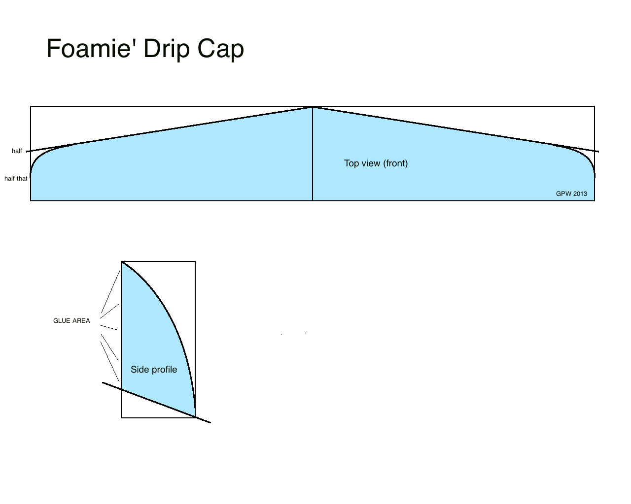

Re: DIY Windows and Doors for Foamies ...
Postby GPW » Wed Mar 16, 2016 7:27 am
Bonnie , just thinking a screen door latch the locking kind with the spring and slider ... Simple , inexpensive , available most everywhere...
If you used Lexan for the windows , that’s stuff's bulletproof ... although somewhat pricy ... Outside pane would be easy ... and like you say , keep the rain off . The magnetic screen on the inside is easily removable and keeps the bugs out .. Round window cutout best supports all stress loads and needs no reinforcing ... just cut a hole ... You could even save the cut out as a plug ...for Winter storage or just privacy ... :thinking:
For WET areas like ours :rainy: , a good drip edge overhead works really well on most every door or window ... !!! :thumbsup: On a Foamie , that’s easy ... made of foam ... 8)

Postby TheOtherSean » Wed Mar 16, 2016 8:14 pm
Interesting little drip cap design there. Thanks for sharing it.

Postby GPW » Thu Mar 17, 2016 5:24 am
Sean , it’s been well tested on the FoamStream .... it really works .. just scrap foam ... Thrifty , and any size you need ... :thumbsup:
