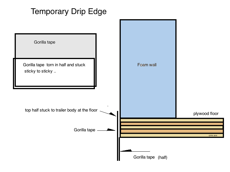

For a really Quick (temporary) Drip Edge , we’re finding Gorilla tape works dandy , and doesn’t look that bad either ... Seems to hold up waaaaay better than regular duct tape...
See drawing ... Something like this will last for sure till the end of camping season ... and probably lots longer till you can get something serious installed ... :thinking:
Temporary Drip Edge ....png (32.64 KiB) Viewed 471 times
