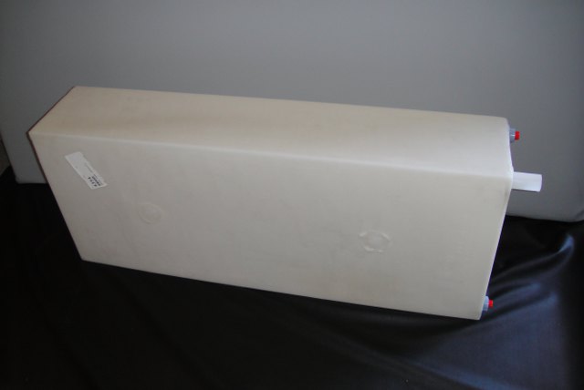

Postby greygoos » Fri Jun 24, 2016 7:12 am
I have used old rv water tanks as the liner. Cut off the top and plug all the fixtures but one. Use that fixture as a drain. You can also use square buckets as a liner. Bakeries throw them out by the dozen and they have lids. You can set them in place inside the foam box and then fill the void with a can of foam.

That’s a Super Bucket idea for a liner ... :thumbsup: I wonder how many “cold ones" you could fit in a bucket , and a block of ice too ... :thinking:

greygoos wrote:I have used old rv water tanks as the liner. Cut off the top and plug all the fixtures but one. Use that fixture as a drain. You can also use square buckets as a liner. Bakeries throw them out by the dozen and they have lids. You can set them in place inside the foam box and then fill the void with a can of foam.
I've been looking around for a liner of some kind. Two great ideas 8) My cooler is 10.5 x 24.5 x 14 " inside, that works great with the 2.5 gal off the shelf water jugs that are so common, freezing one of those is my preferred way to go. I would love to find a liner that size. I think I will try to make this cooler a little higher.

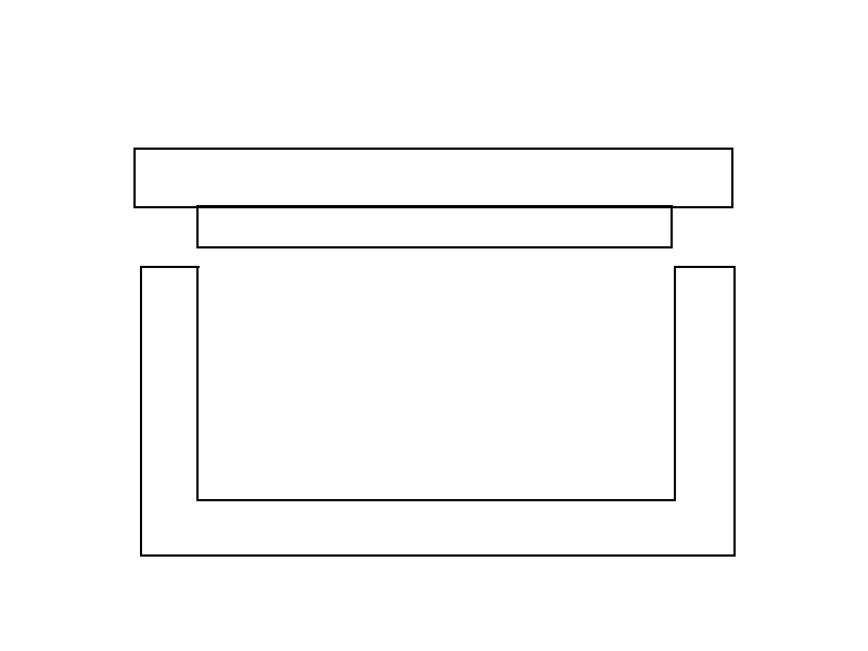

Postby GPW » Thu Jun 30, 2016 6:33 am
The Old coolers were wood with metal inner liners (galvanized) and cork insulation ... and that worked ... :thinking:
Yes about the sealing , even a small crack adds up to a good size area ...Good “fitting “ of the parts is the answer...Having a top with a protruding area acting as a “plug” also helps ...
(see sketch)
We’re planning on a more “stationary” cooler that won’t be moved around when it’s full. ( easily moved when empty ) So won’t need handles or any exotic strength ... much like the cheap 99 cent foam coolers we’ve all used for years ...

GPW - I know the "plug" top is the way to go, but I don't want to lose 2" off the interior height of the cooler.... I'm thinking about using epmd rubber or foam weather stripping to seal the two.
The exterior dimensions are 21L x 18W x 15H

Postby GPW » Fri Jul 01, 2016 5:15 am
Guys , when given a choice between complex and Simple , I always gravitate to SIMPLE ... I’m referring to those 99cent foam coolers we see EVERYWHERE :o :shock: They are really pretty effective and without a lot of extra additions ... The lid is close fitting which seems to work fine ... And if you’re going to sit on it ... ( “ I'd really like to have the cooler double as a seat, “ ) That should keep the lid on eh ? :thumbsup: ( see: Newton)
One little point :roll: ... I don’t think (JMHO) a Foamie cooler is gonna’ be suitable for off road banging around ... Much as your kitchen refrigerator ... There’s specialized coolers for that ( Big bucks ) ... I’m thinking something that lives in the trailer and is for long term food storage . ( or Beer eh !!! :beer: ) All based on the idea that the more foam you have , the better the insulation ( Plus that sealing business) and the longer your goods stay cold ... :snowstorm: :snow SIMPLE !!!

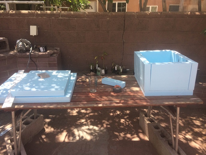

Postby tac422 » Fri Jul 01, 2016 10:56 am
So...
I like this idea, and I've got a few scraps of the Big Pink just layin' around. :thinking:
Presenting:
the start of "Lil' Pink " :lol:
143211
143212
143213
