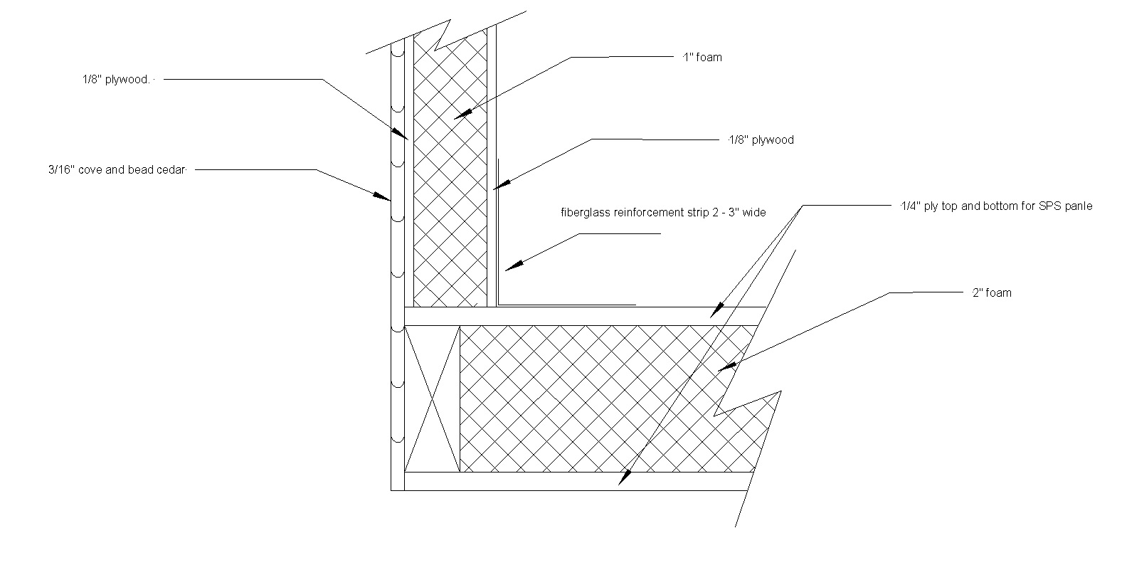

Ok, these are the changes I made for the foam wall. I got some 1/8" ply for both sides of the side walls. I will make a SPS panel, and then I will glue the
cedar strips to the 1/8" wall. This should make a very lightweight and strong wall.

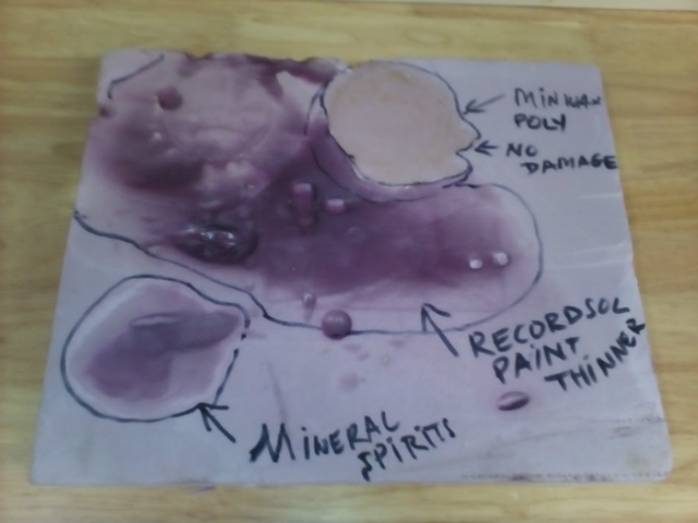

Here is the components for "the mix" I used: spar varnish(polyurethane based) and/or Minvax polyurethane and oil paint solvents like mineral spirit and/or recordsol(same stuff). I did the same test as GPW did above here. The photo below shows that the foam does NOT dissolve by these solvents, minvax or spar varnish mix within half an hour or so as the mix and solvent dry:
But when I had used this very same mix on the trailer build last year, the mix apparently remained wet for an extended period of time as I put some generous amounts on the surface of the internal compartment made of baltic birch. Some of the mix had leaked from one compartment towards the foam. It hapenned only in one out of three compartments and within a few days the foam started to soften in the area outside of that compartment bottom. It must be noted that the foam did NOT dissolve like if it would be by an acetone. It just started to loose its rigidity and became "spongy" and structurally unsound to the point that I decided to remove the damaged soft foam area and replace it with the great stuff foam. See below the finished repair area already covered with fiberglass:
Since we started this discussion I decided to look up the XPS chemical resistance properties of XPS foam online and found one refence where it has a table of chemical resistance of Polysterene foam against various hydrocarbons, not exactly mineral spirits, but petrol and diesel are close enough to it, see it on Page 3 of this document - http://www2.basf.de/basf2/img/produkte/kunststoffe/styrodur/downloads2/en/styrodur_chemical_resistance.pdf
Looks like the XPS foam may not get the effects of mineral solvent exposure immediately, but when, like in my case, the exposure was long enough, the damage in a form of softening can appear.

R. W. Alexander wrote:Ok, these are the changes I made for the foam wall. I got some 1/8" ply for both sides of the side walls. I will make a SPS panel, and then I will glue the
If glued properly, this will produce a substantially stronger than a present day commercial trailers filon+foam+luan typical sandwich wall. It may not be lighter though.
Back to protection from weather, I would personally still protect the wood with epoxy and glass cloth like they do on wood canoes. I just got the feeling that w/o fiberglass or canvas any wood with any paint cover, no matter how good it is, the expansion and contraction of wood would eventually manifest small cracks on the surface. Subject to weather exposure, of course, and YMMV.

GPW wrote:Tested just now ... Four different foams ... First coat of pure Mineral Spirits , then a dab of pure Poly ..... Although you can see pooling of the poly there is no signs of any melting ... 143353
GPW, may I ask you to do the same test, but cover the pools of your solvent and the mix with polyethylene for about a day or os and then and report the results?
In my tests from yesterday I noticed slight caving in from dried out mix. It is nowhere close to acetone damange which would just it the whole peace, it is like some heat was melting the foam, but left the foam softer than before. I would like to find out why we now have different results.

Postby OP827 » Sat Jul 09, 2016 9:10 pm
Below are my test results of the XPS foam chemical resistance from
1) Undiluted Minwax polyurethane,
2) Recordsol paint thinner for oil based paints,
3) Mineral Spirits.
All the chemicals were put on the same piece of foam and then covered with polyethylene film. After two or three hours of such exposure, the XPS foam started to dissolve from Mineral Spirits and Recordsol, while MInwax did not visibly affect the foam. See the photo below.

Postby OP827 » Sat Jul 09, 2016 9:16 pm
Recordsol amount was bigger than Mineral Spirits, but the damage is only slightly bigger comparing to Mineral Spirits. Recordsol seems to be little bit more agressive to XPS foam.

Postby OP827 » Sat Jul 09, 2016 9:22 pm
KCStudly wrote:Seek out the SDS (MSDS) for the Recordsol and I bet you will find that it includes some sort of chemical solvent.
Yes, you are right about that KC, Recordsol has 10 times more Aromatics, here is the difference between Recordsol and Mineral Spirits explained - http://www.recochem.com/us/products/cleaners_degreasers/odorless_mineral_spirits

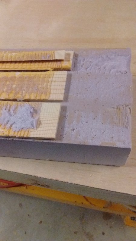

Postby R. W. Alexander » Tue Jul 12, 2016 9:22 am
I did a test piece on some foam for a possible woodie wall. I did canvas on foam with a 3/16" thick wood exterior, using titebond II.
And another piece without the canvas. Both test pieces were good, and strong
The wood to foam is more than strong enough for my build, plus I can save weight by not using the 10oz. per yard canvas on the outside.
