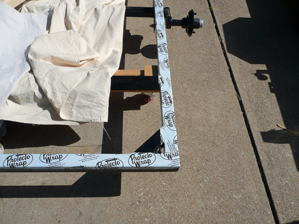

On the cedar frame that i've built, I've tried to minimize the exposed punctures for the stainless steel screws that must be used to attach the frame to the chassis, and the screw heads are driven flush, not depressed. There are none directly exposed to the weather. I suppose that at installation I could have stopped at 1/4" and put a dab of PL Premium under the heads to embed them.
I definitely plan to install a drip cap/edge at the wall-to-floor joint, with care not to leave a sharp edge at the door openings. A bead of PL Premium will be laid under & on top of the drip cap, laid on the frame, and then the wall will be placed. The Z-profile window drip cap comes in 1-1/4" and 1-5/8" widths and 10ft lengths (the 10" description on the webpage is wrong). The L-shaped roof edge has an angled edge that is better for shedding water, but it doesn't have the Z profile that extends up the inner side of the wall.

My floor is sandwich construction - 1/4" ply, 3/4" framing and foam (1x2s laid flat) and 1/4" ply. It is attached to the 2" x 2" trailer framing with trailer deck screws that only penetrate the upper surface of the square tubing.
Before I fastened the floor, I covered the upper frame surfaces with window flashing tape. The flashing has a bituminous layer that seals penetrations from fasteners. In this instance it seals around the deck screws.
Although the deck screws are self-drilling, I pre-drilled the for deck screw holes through the floor framing only and not into the steel tube trailer framing. I then used a syringe to squirt sealant into each hole, similar to this picture:
When I fastened the trailer deck screws, there was "squeeze-out" of the sealant. With the ends of the deck screws inside of the square tubing, and the window flashing tape plus sealant, I am confident that there is no pathway for moisture to migrate.
Take care,
